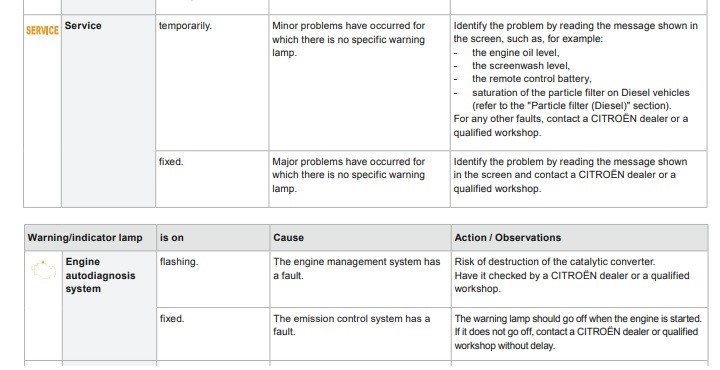

Having just bought a DS3 recently, and thus reasonably familiar with the handbook, there are a multitude of reasons that may illuminate the engine management or Service warnings. p27 onward in the handbook will help you narrow it down.
As the light illuminates initially, then extinguishes fairly quickly, I would be thinking about a transient sensor error that may be caused by low battery voltage - possibly one of the things Marc is thinking of when asking if the car is only doing short journeys. The recent cold weather will exacerbate a battery reaching the end of its life, or not having the chance to replenish itself when very short journeys are undertaken.
Halfords will test the battery for free - https://www.halfords.com/car-repairs/ca ... TTERY.html - though of course they do this not out of charity, but because they expect to be able to sell you a new one.
Martin.
