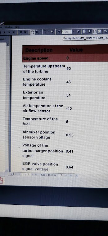

HI All
can anyone tell me does this look like the MAF temp has failed,
this is looking at the car first thing before it’s been started in 12hours and not actually running, what throwing me is that there are other temps reading in the 40's even though it’s not been started, unless its remembering these temps from when it was last started .
