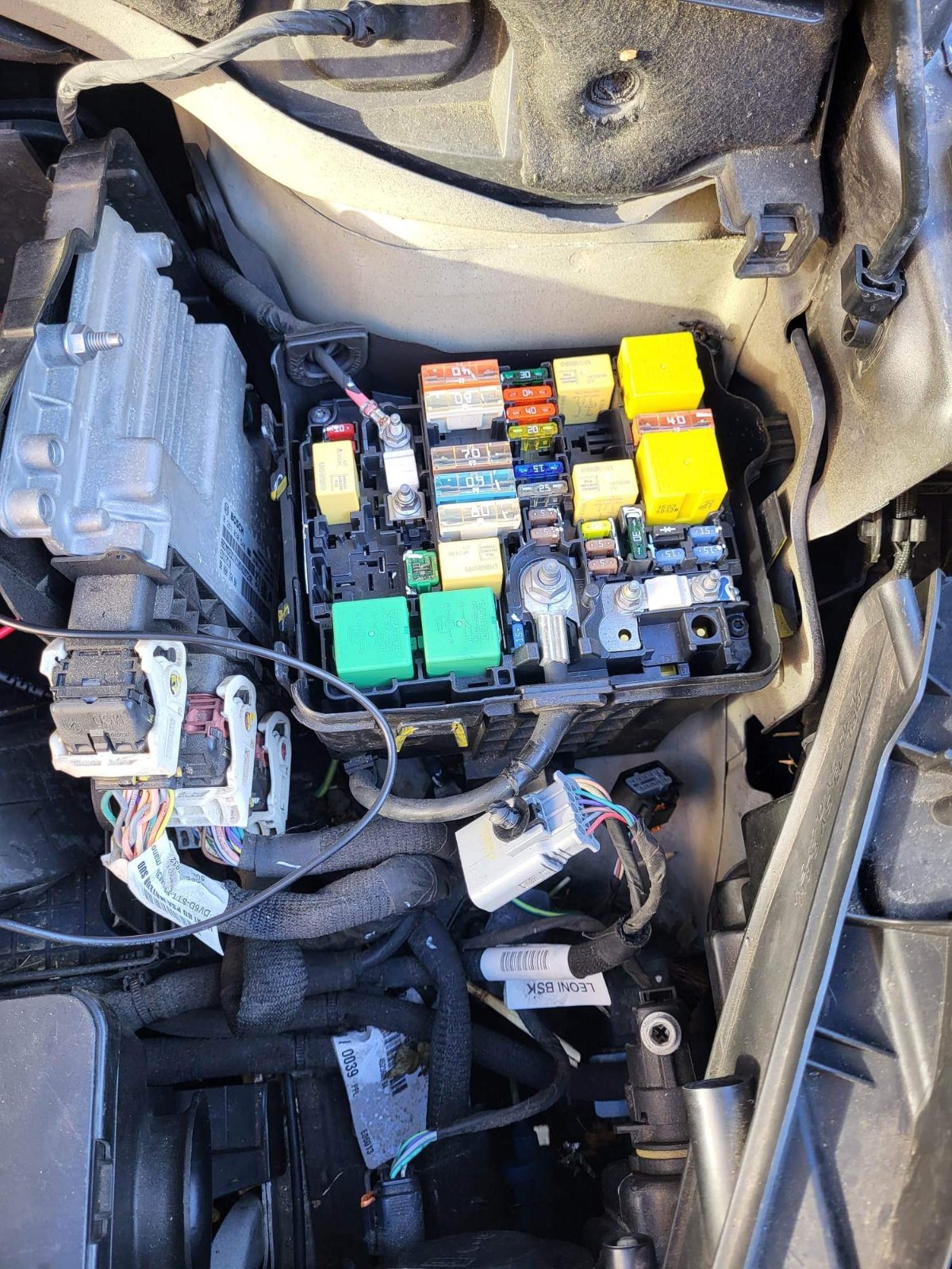

Re: Peugeot 2008 u1134 error code
Hi Mel I'm unable to locate the wiring harness you mention, can you tell me where its located from this picture? Thanks for your help
Hi your car maybe a bit different mine is a Stop Start C4, the bottom right hand corner of fuse box just inside the wing from the engine bay there should be a 6 wire plug similar size to grey plug on your photo it is heading to your Stop Start ECU above passenger wheel.
