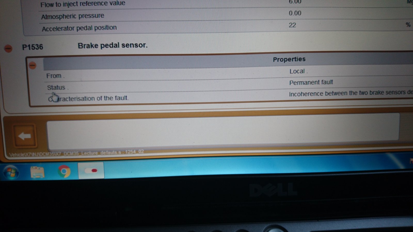

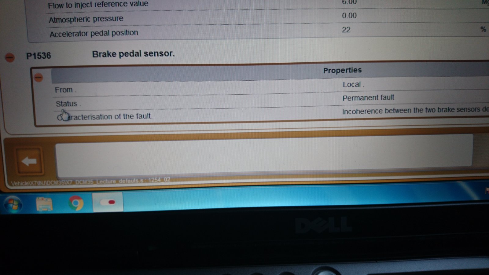

Hi All

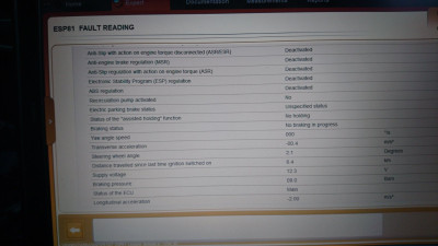

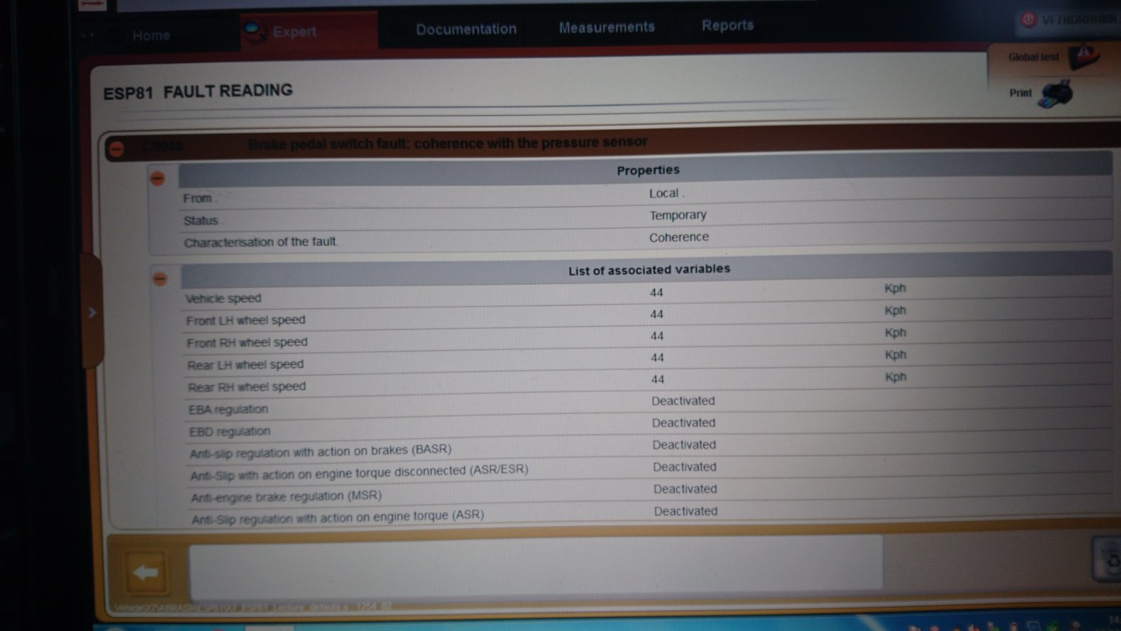

My C5 X7 after having the starter motor replaced has now thrown up ESP/ABS warning lights. I have not yet driven it to see it happen but it popped up on Tuesday morning once and nothing showing up again until Friday morning.
Popped out with the Lexia and nothing showing on the dash when engine started and stationary but do have faults stored. Cleared all faults and another global scan came back clean.
Seems to me that it all down to the 2 Brake sensors but which one.
Hopefully not too expensive [-o<
Colin

Re: C5 X7 ESP/ABS fault with codes and pictures
Ok, so this is a long one Colin.
1) Fault Codes
2) Part for harness / Switch
3) The TSB for a known issue concerning malfunctioning of the stop lamps and / or lighting of the ABS / ESP Warning Lamp
So here are both those faults and they are obviously related:
1) Faults:
Fault Code: P1536
Description of Fault: Brake pedal sensor: Incoherence between the 2 brake sensors detected when decelerating.
Incoherence between the main brake and the secondary brake during a gross deceleration for 1 second.
Engine running.
Conditions for Fault to clear: Driving with engine hot for 5 minutes with numerous brakings
Downgrade Modes whilst Fault is active:
  • Deactivation of the injector resetting strategies
  • Irreversible deactivation of the vehicle cruise control (Need to switch the ignition off and then on, in order to make the function available again)
  • Deactivation of the after-sales test for detection of leaks on the diesel fuel high pressure circuit
Symptoms:
  • Lack of power
Suspect Areas:
  • Brake pedal
  • Brake switch
  • Electrical harness
  • Connectors
Fault Code: C0040
Description of Fault: Brake pedal switch fault: Coherence with the pressure sensor.
Ignition switched on.
The time of appearance of the fault code is 1s
Incoherence between the calculated pressure and the movement of the brake pedal
Incoherence between the pressure at the master-cylinder (higher than 80 bar) and the movement of the brake pedal (zero)
Warning Lights:
  • Service
  • ESP/traction control
  • ABS
Conditions for Fault to clear: Coherence between the calculated pressure and the movement of the brake pedal.
Coherence between the pressure at the master-cylinder and the movement of the brake pedal.
  • The ABS operation that is current goes its term. Once it is finished, cutting of all ABS operations
  • Immediate cutting of all the speed control functions (ESP)
  • The electronic brakeforce distribution function is in down-grade mode
  • Deactivation of the hill start assistance
Symptoms: Lighting of the ABS and ESP warning lamps.
Suspect Areas:
  • Pressure sensor (Internal to the ECU ESP)
  • Fuses
  • Electrical harnesses
  • Connectors

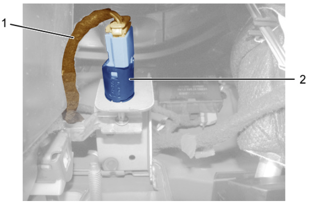

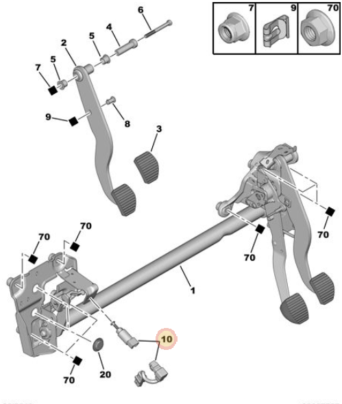

2) Parts
Be aware that there are 2 possible types of brake switch (manual adjustment and automatic adjustment).
This is the part:
Item (10) Strap Switch Kit, part: 453467, £55.13

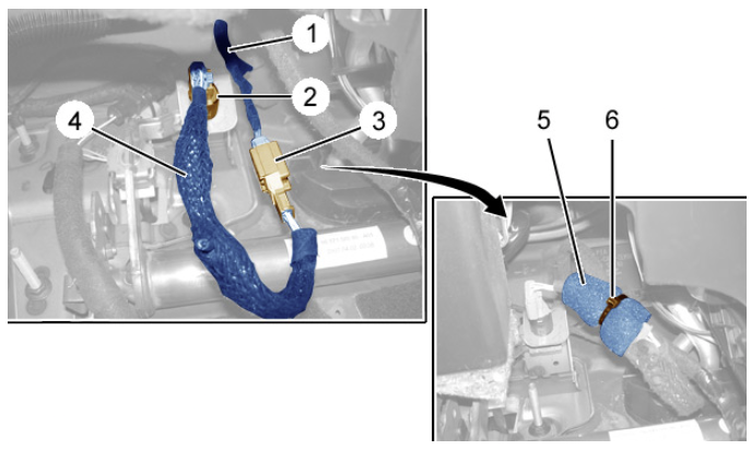

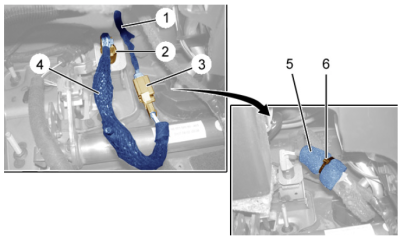

3) TSB Details
Fault Origin:
Brake Switch (on braking)
Repair:
  • Install an intermediate electrical harness.
  • Replacement of the brake lamp switch.
Parts Needed:
  • 1 Switch kit (See part no. above).
  • 1 Plastic clip (Packaging of 50 - Part number 6980A1).
  • 1 Foam (Packaging of 20 - Part number 936572).
Disconnect: The electrical harness (1).
Replace: The brake lamp connector (2).
Position: The intermediate electrical harness (1):
  • Connect the intermediate electrical harness (1) to the stop lamp switch (2)
  • Connect the other end of the intermediate electrical harness (4) to the electrical harness (1)
  • Wrap the connector (3) linking the intermediate electrical harness (4) to the electrical harness (1) with the foam (5)
  • Attach the 2 electrical harnesses (1), (4) together ; Using a plastic clip (6) (Moderately tighten)
  • Cut the excess length from the plastic collar (6)
Check that there is no interference between the electrical harnesses and the pedal gear.

Hi Marc
Thanks for the info think i am going to have to gain access and get some pictures of what is currently on the car.
I have spoken to the good lady and when it came up on Friday she was overtaking a car on a dual carriageway and not breaking so my head ( and wallet ) is leaning towards the Brake Switch when looking at C0040 when it states Zero movement of the brake pedal.
Would you be ok if i take some pictures of the part on the car and advise me if it is the manual or automatic version of the switch?
I guess that the price for the Strap switch kit includes everything i would need and can be ordered from my local stealers :)
Thanks again Marc really appreciate what you and the other Leaders do.
Colin
x 6945
I can't say if the clips are included or not Colin, they would have to advise you of that at parts.
As for the switch removing and fitting, I included the procedure a while ago in another thread here with pics:
viewtopic.php?p=604210#p604210

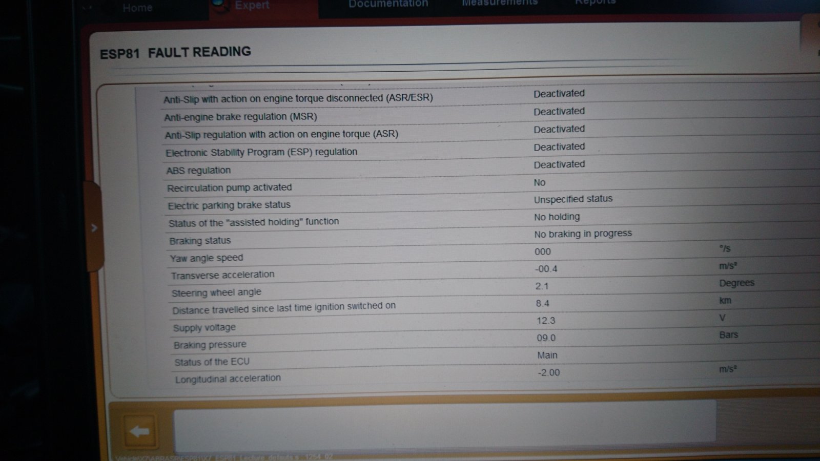

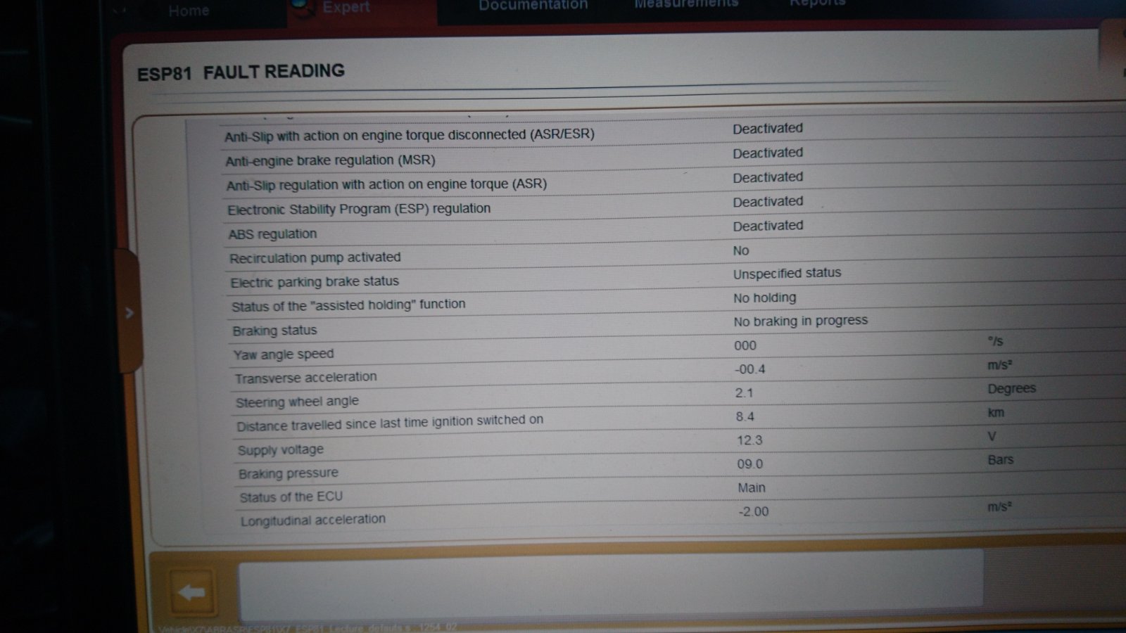

Ok just a quick update.
Cleared all the codes yesterday and finally got chance to take it out to see if i could get it to throw up the fault.
I have only managed to get it to throw up the fault once and having done another scan it is the same 2 codes C0040 and P1536.
It only came on when i was doing maybe 5 mph and stamped on the brakes hard. Switch engine off and on again and fault has gone. I have tried standing on the brakes from various speeds up to 40 mph and the car just behaves itself.
So going to take it to work and back tomorrow and see how it behaves.
Yes i will be getting it replaced i just want to see how intermittent the problem is and knowing the car will have no ABS/ESP when the fault is active i at least know what to expect, it has brakes just no ABS.
@Doo It is a little bit different on the C5 X7 there are a couple of switches, one is plug and play the other needs manual setting knowledge gained from the ever reliable Marc.
Fingers crossed the one i have is the plug and play variety
Colin
