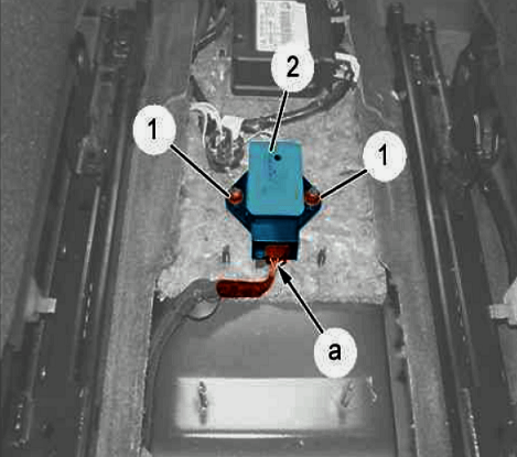

Anyone know where is "gyroscope" located on Peugeot 5008 2015

The gyrometer-accelerometer sensor is located under the handbrake and measures the following parameters:
  • Yaw speed
  • Lateral acceleration
  • Longitudinal acceleration

Marc hanks for answering. Any suggestions how to remove sensor?

You'll first need to remove the central console to gain access using trim tools, then you can see it here:
Remove the nuts (1).
Disconnect the connector (at "a").
Remove the gyrometer/accelerometer sensor (2).
Be aware if it is removed for any reason, it will probably need recalibrating with Diagbox on refitting.
