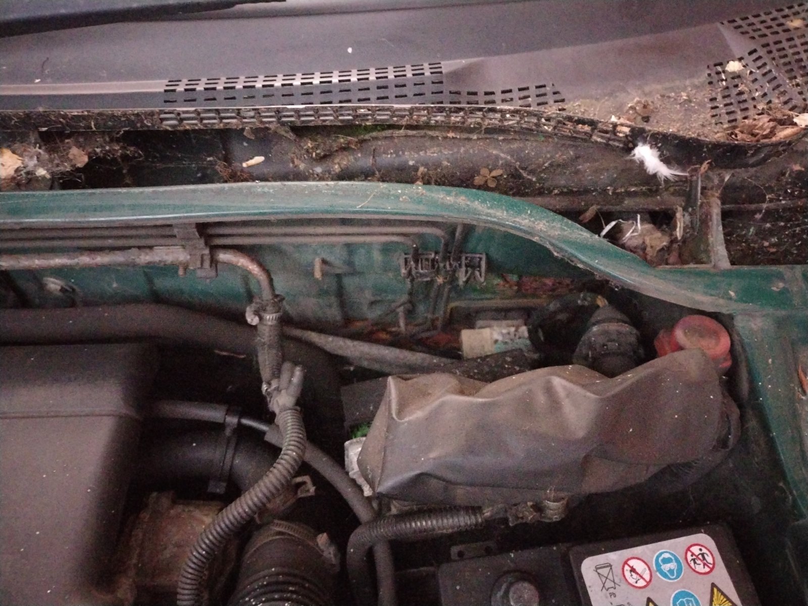

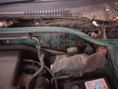

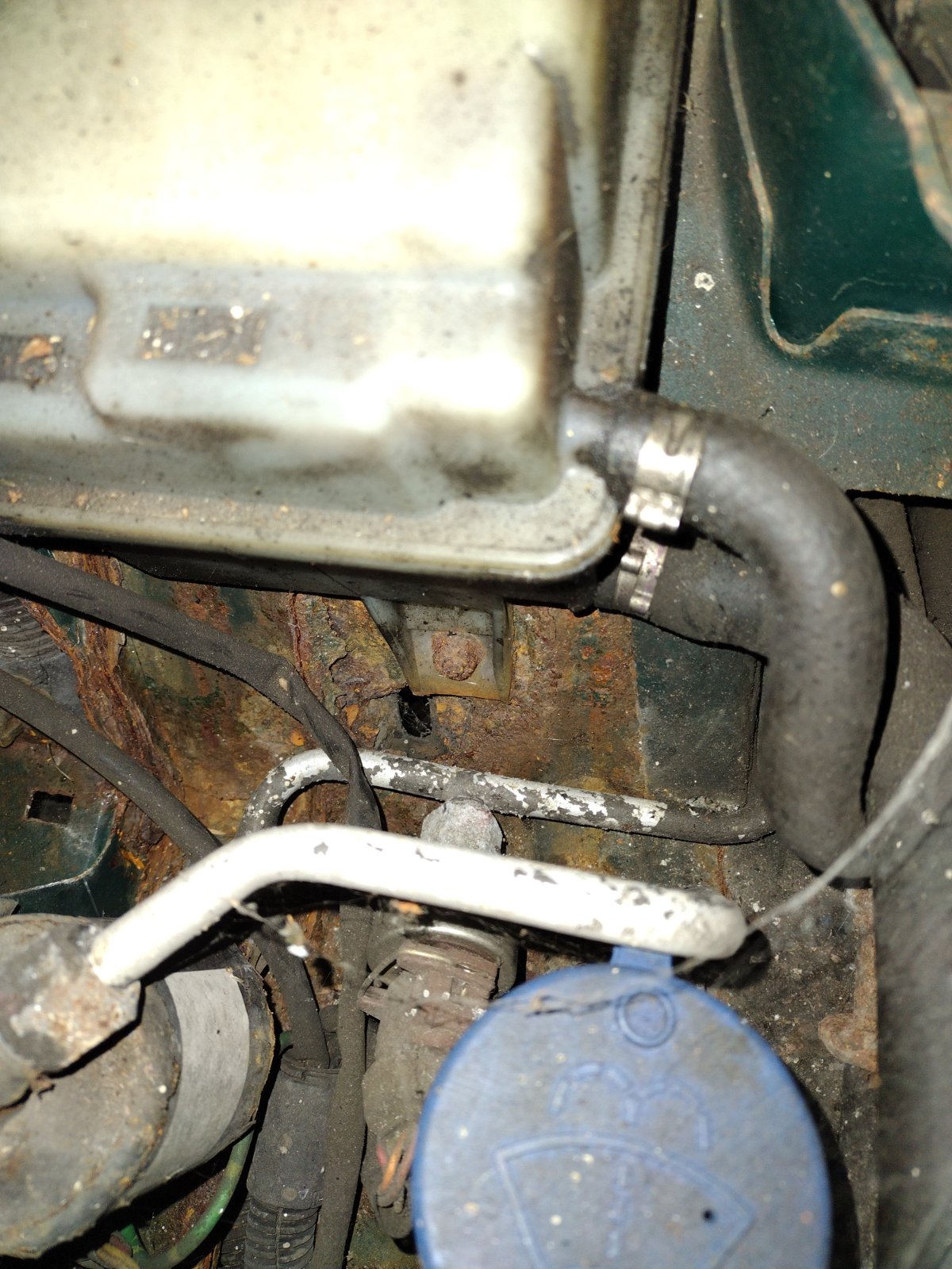

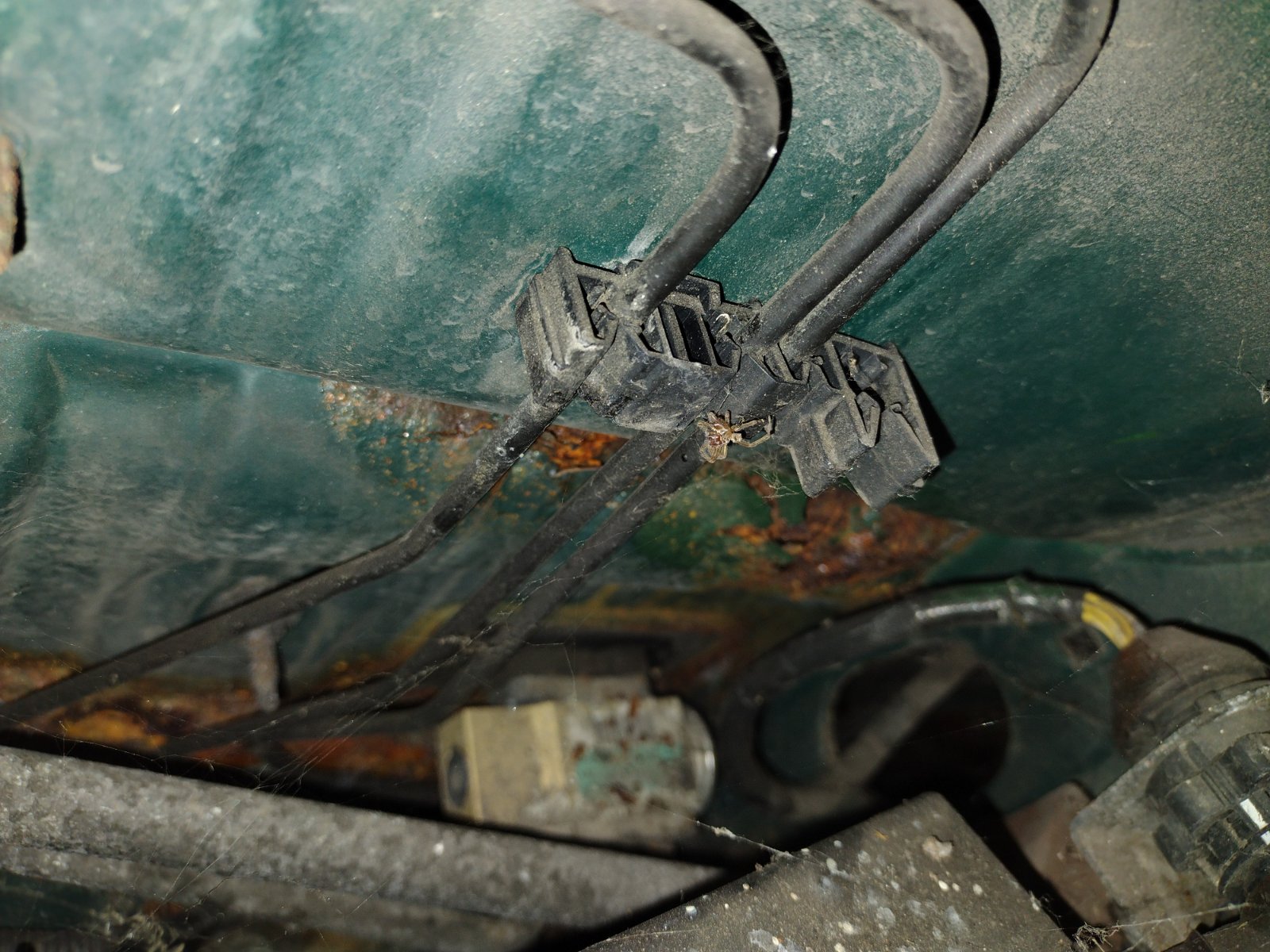

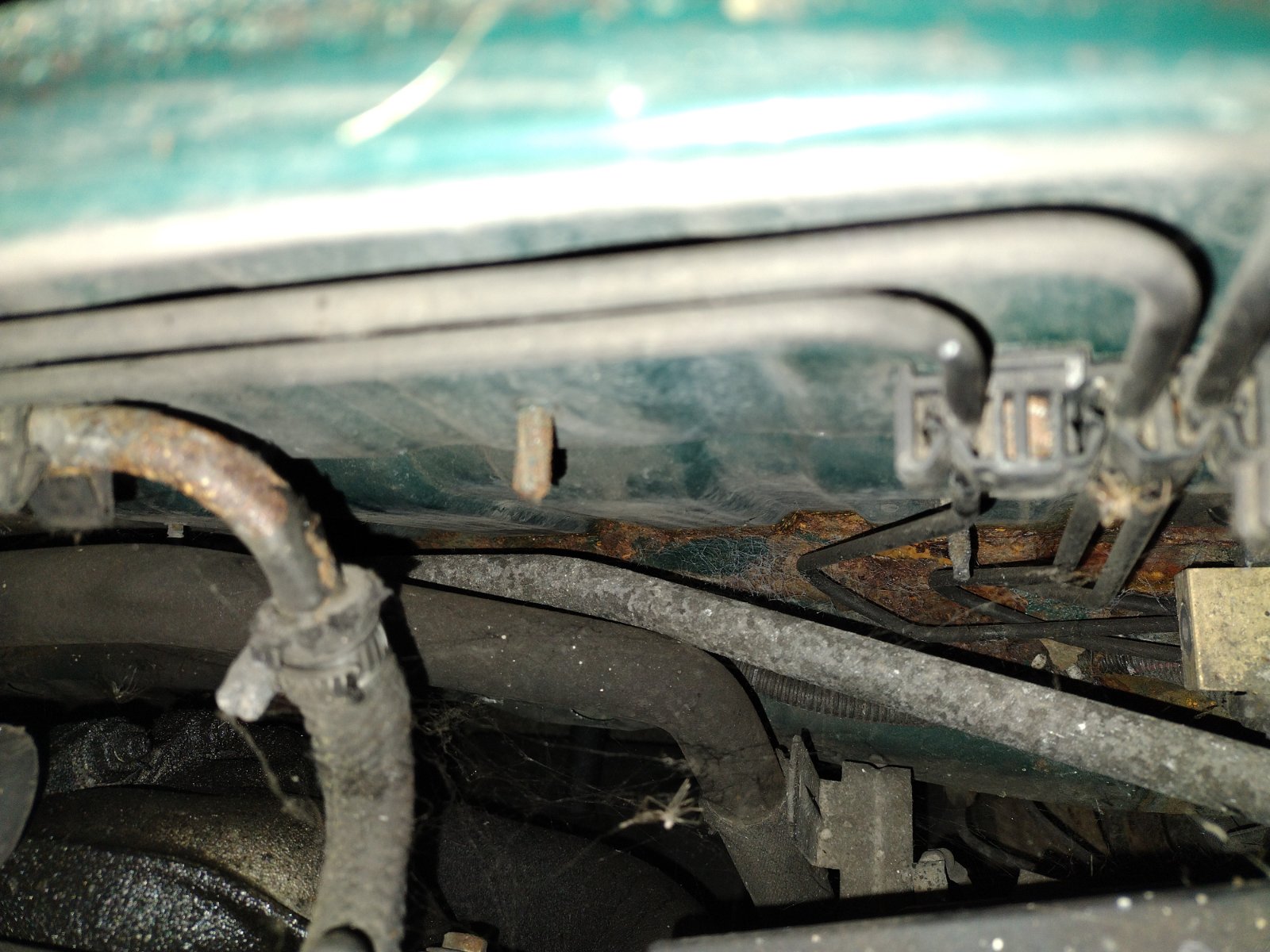

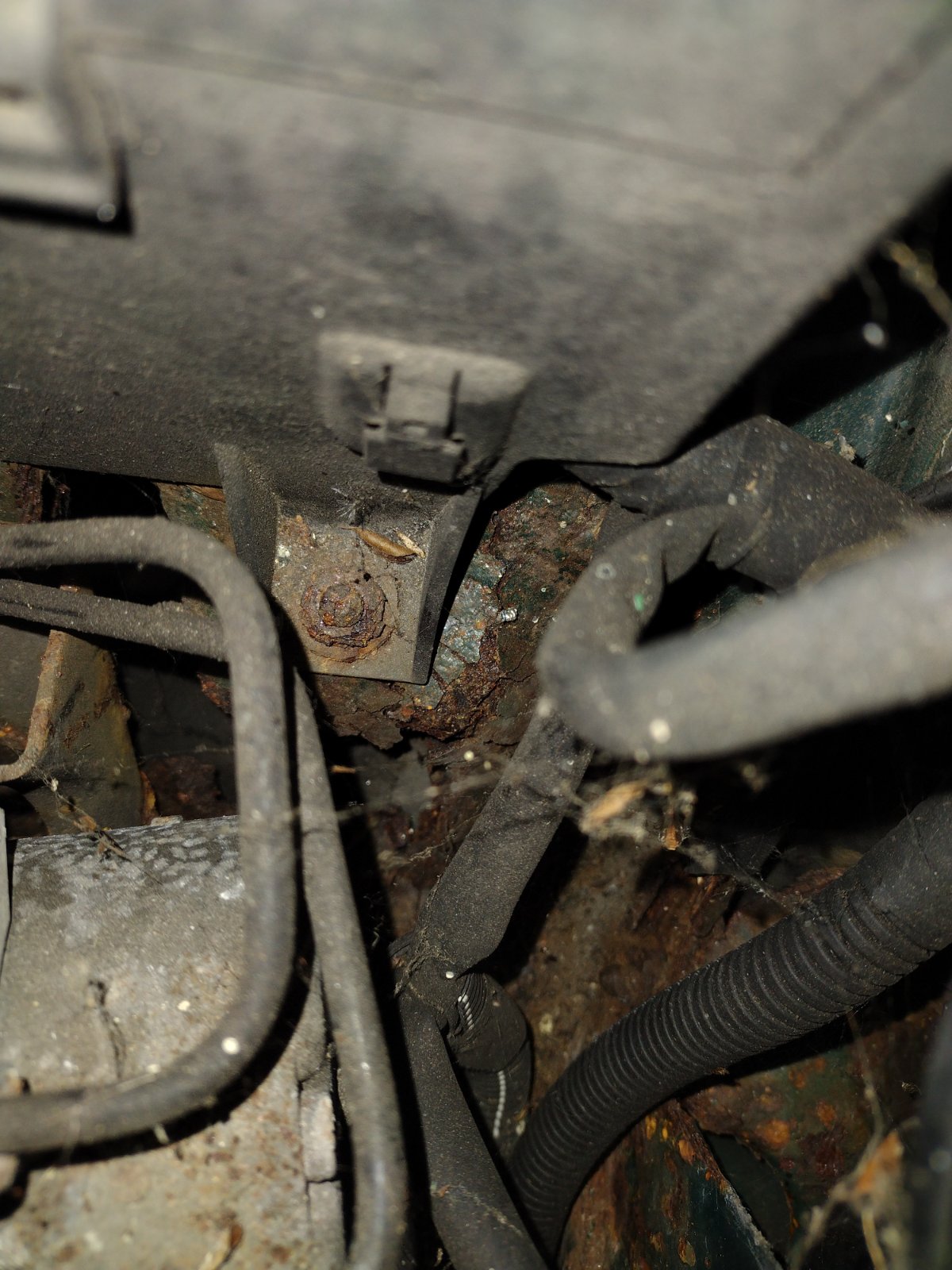

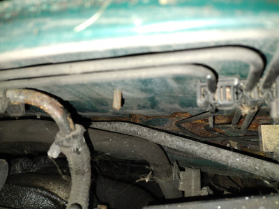

I'll take a picture in the daylight tomorrow - I'm not sure if there's a "common" place for them to go, but you'll at least see where mine has gone
Will show front inner wings - also failed on mine.

- Posts: 5325
- Joined: 25 Apr 2022, 09:03
- x 2347
Re: 306 bulkhead rot
Inner wings
Right Left All pretty horrible for access and in terms of current condition!

How old is yours Matt? And what sort of life has it led? Is it Scottish by any chance?
That all looks quite serious... If the bulkhead needs structural repair it looks like it might be an engine out job...
Inner wings too... It would certainly make it a bit easier access-wise...

1999 V reg. 229 thousand miles on the clock.CitroJim wrote: 01 Dec 2022, 18:59 How old is yours Matt? And what sort of life has it led? Is it Scottish by any chance?
Not sure if Scottish, but don't think so, reg ends FSU - I know some clever folks can determine location/ registration district from that???
Yes, expectation is engine out, dashboard and front carpets out. Maybe unbolt outer wings too help access.
Whilst engine is out will clean up (is doing the self preservation trick: cover itself in oil) and swap inlet manifold for the HDi 110 version I've bought and already cleaned out the EGR crud.
By most metrics my 306 is end of life, uneconomical to repair. I'm planning to have a go at fixing it as fancy the challenge - and if I fail then it'll only end up taking the route it would if I didn't bother.
