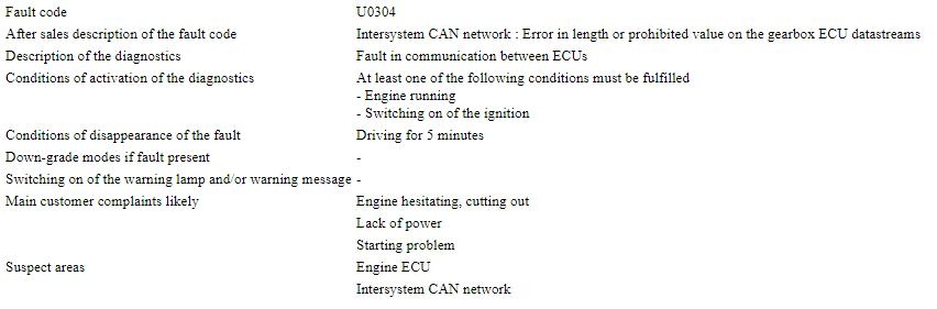

A problem has arisen since the replacement - a fault code on the engine computer "U0304" - incompatibility in communication with the gearbox.
The car stalls regulary when coming to a stop and sometimes, stalls after firing up. After looking up the fault code - the symptoms seem to align with what we are seeing. Stalling, hesitation, difficulty starting etc.

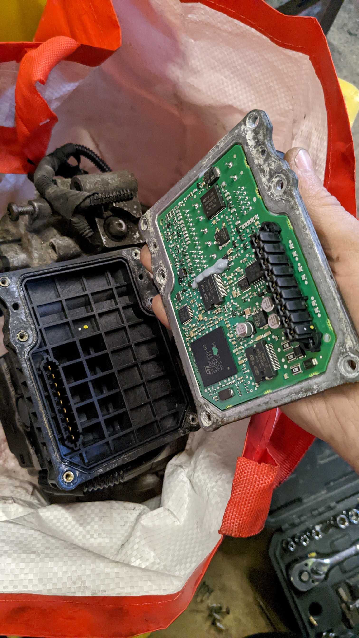

Hardware looks identical - I'm guessing its simply different software loaded onto the mcu/eeprom?

Turns out the circuit board is super easy to swap over. It was apparent that both boards had different componentry. Once the boards were swapped, the fault codes cleared and everything was perfect again. Hopefully this helps whoever wants to swap actuator assemblies from different vehicle configurations
