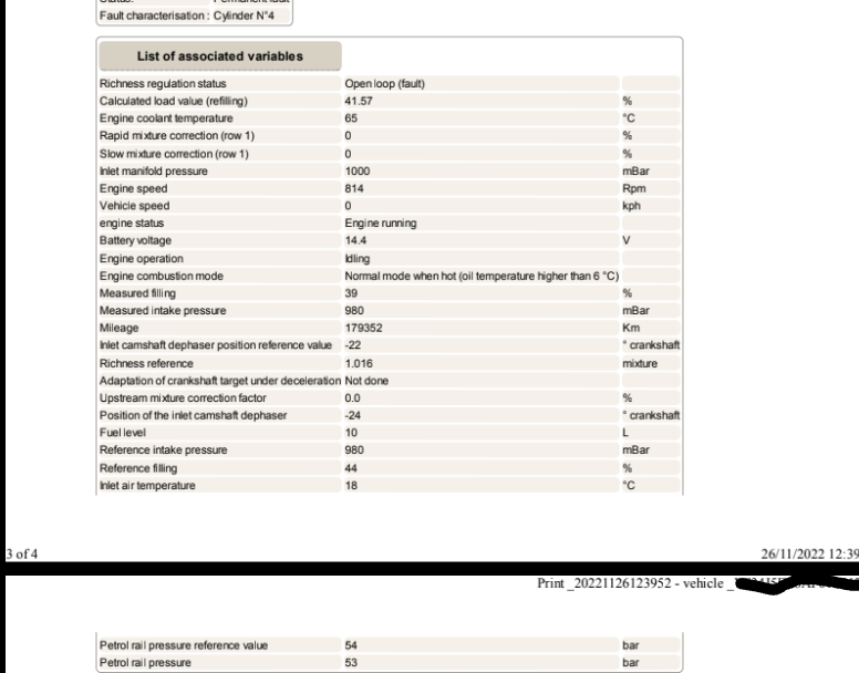

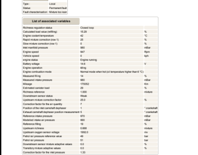

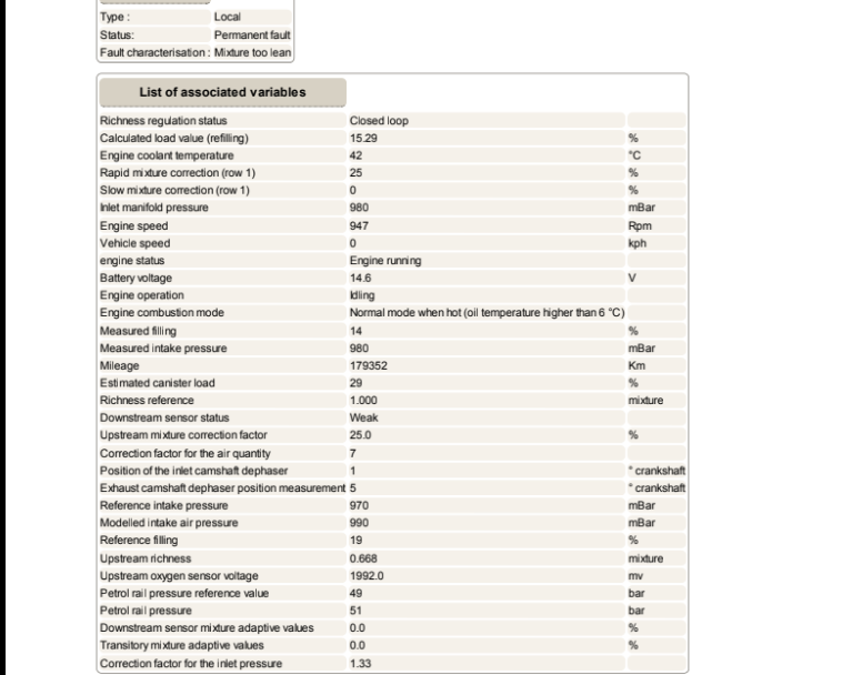

Hey the thanks for the reply the fuel trims stay maxed out at 25% on both st/lt on upstream and a steady 625mv on the downstream I've been all over it with a propane torch and can't find any vac leaks I think the vanos system isn't completely closing the intake valves at idle. I'm going to try and reset the adaptions tomorrow to see it makes any difference.

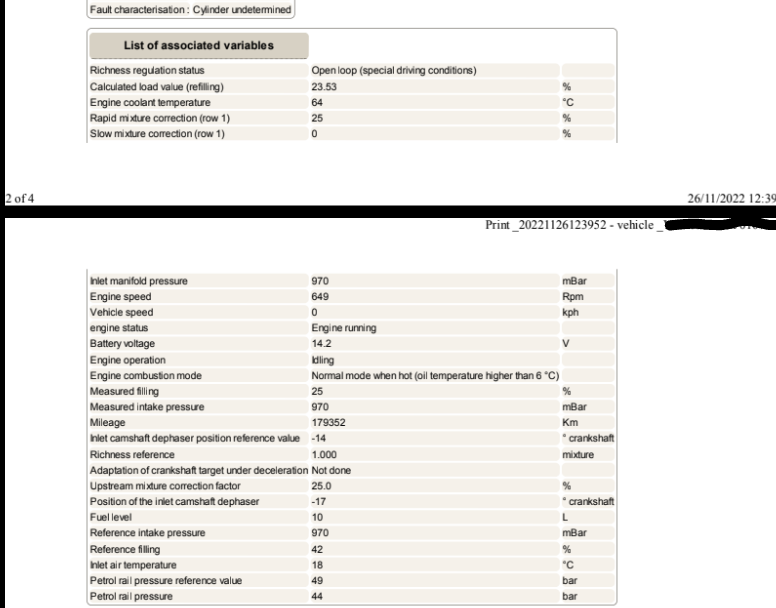

Re: Rcz headache running lean can you help with diagbox read out
It would be good to tell us about the background to you needing to get the engine rebuilt and what the inspection revealed. At 180,000 km I can imagine that it would be pretty sooty with valve guides and oil rings suspect, as well as sooty inlet ports and valves, and maybe exhaust as well? How was the compression? Out of curiosity, were any compression rings seized? Was the head dismantled to allow replacement of the valve guide seals? Was there any concavity in the cylinder head and how flat was the block face. Was the hardness tested?
In the two engines I have overhauled they ran very badly for about half a dozen starts before the ECU sorted things out. I never knew how to set the stops for the eccentric cam controlling the valve lift but the car eventually sorted itself out.
I'm not familiar with much of the data presented but it looks to me that your inlet Vanos position agrees with the desired reference value and that there is nothing wrong with the pressures generated by your HPFP.
It is not unknown that the Vanos units can be put on the wrong shaft, although they are clearly marked. It is also possible to muck up the valve timing - there is more than one hole in the flywheel into which the crankshaft timing pin can be inserted, and you should check the height of all 4 pistons is the same when the pin is inserted. You can just about tell by eye if the flat tops of the camshaft timing lugs are horizontal with the face of the head but of course it is much better to use the correct tool. If everything checks out ask the mechanic how they held the camshafts still while they did the 180 degrees angle torque on the end retaining bolts. There are astute people who advise against using the 27mm hexagons that hold the camshaft position sensor assembly to the other end of the camshaft for fear that you may alter the position of the timing assembly on the camshaft. I don't think you can recover from this and I'm not sure how you would check it.
There is also scope for wear in the variable valve lift eccentric shaft to cause engine running problems but if this assembly was dismantled any excessive wear would have been noticed.

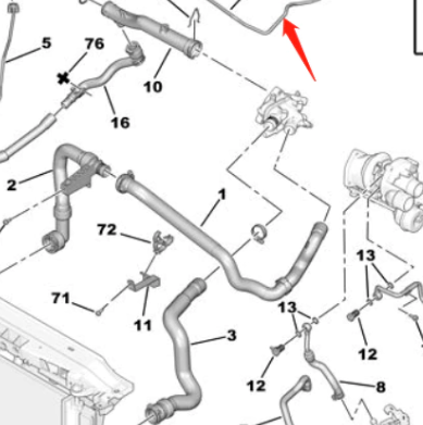

so after a late evening of trouble shooting ive still got a missfire on cylinder 4 and ive noticed that if this diagram is correct that it appears the radiator pipes have been put back on the wrong way round as service box says they go the other way so im a little confused thinking maybe ive killed it now installing it backwards.

If all you have done is change the direction of flow in the radiator I wouldn't be too concerned! And since it looks like there are no branch lines on both these hoses the flow in any ancillaries would not have been affected. The large diameter thermostat outlet at 9 o ' çlock closest to the head has an arrow facing out- that goes to the radiator inlet. The one just out from that is the return. As I understand it the thermostat controls the temperature of the water entering the coolant return pipe that runs behind the engine to the water pump. This pumps the water into the block. The temperature sensor monitors the temperature of the water leaving the cylinder head.
