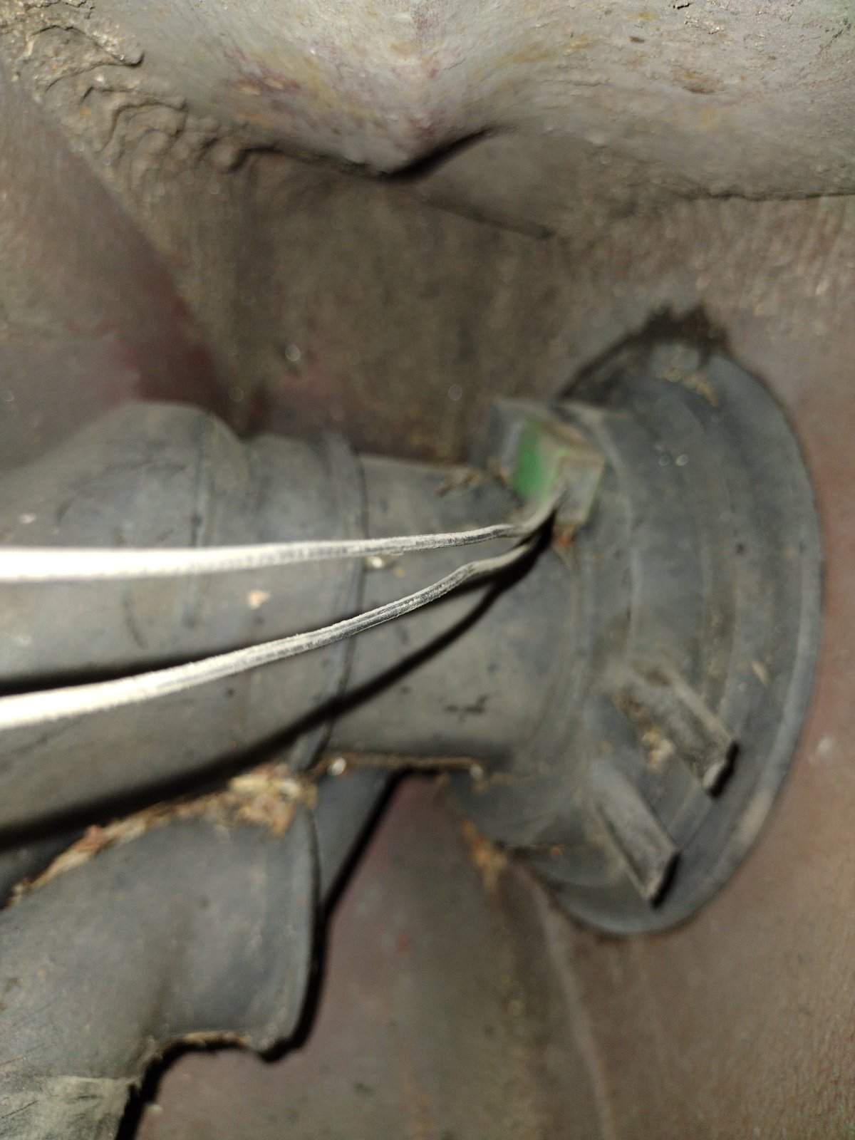

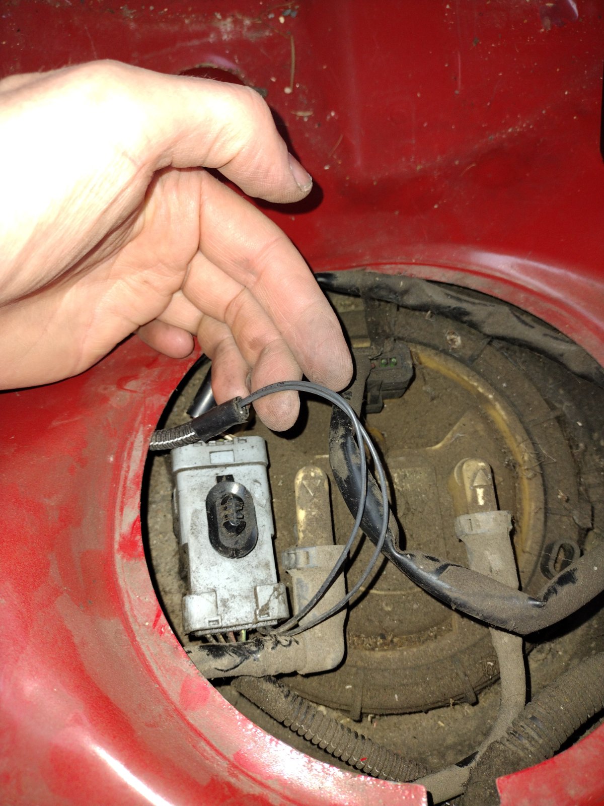

Have error code for tank sensor fault (will look up the code shortly, have it written down)
Cap has two magnets present and correct.

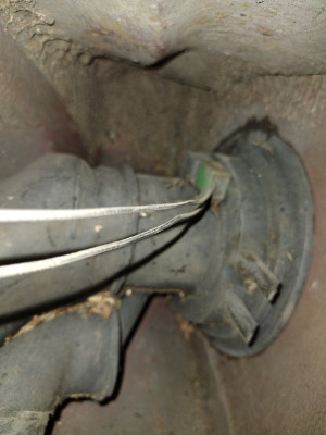

Dug into right rear wheel arch to remove current sensor and check its wiring.
How does the sensor actually unclip from tank inlet?
Secondly, is there any specific resistance it should read if ok / dead?

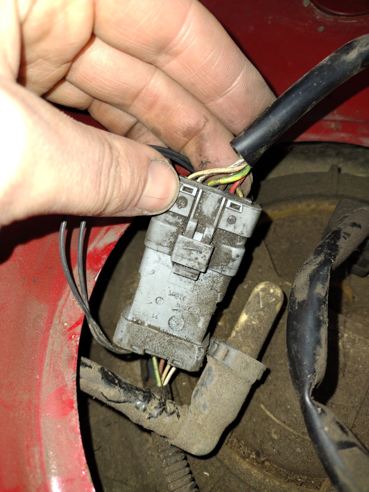

Third and final question, is it a case of splicing the wiring as seems to be fed direct to a larger wiring plug - visible from under right rear passenger seat base tank access hole:

Top end at the tank neck is just sitting in the rubber seal, no clips or screws, this is the test but it's foreign and quick.

Perfect, thanks - will nip out in the dark after tea and have a play with the multi meter.Gibbo2286 wrote: 27 Nov 2022, 16:33 Top end at the tank neck is just sitting in the rubber seal, no clips or screws, this is the test but it's foreign and quick.
Will have to get a bit more forceful and see if can get sensor detached. I loosened plenty of dusty dry road muck to tumble down towards my eyes, but no movement of the sensor itself

Wiring looked ok, no obvious damage. Connection also looking ok too.
Magnets both present and correct.
