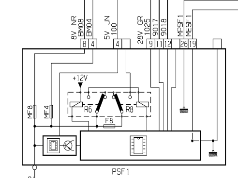

Engine is the DW10CTED4 Richard - and I can't see any direct fuse listed on the ignition or starter circuit. The Starter solenoid connection (wire 100 on pin 4) seems to go directly to the ECU in the engine fusebox. MF8 and MF4 are BSI supplies, so I would expect a lot more issues if these fuses were faulty.
Traditionally a clicking on starting often indicates sticking brushes in the starter, so if you have home start, get them to test it and get it towed after Colin,
