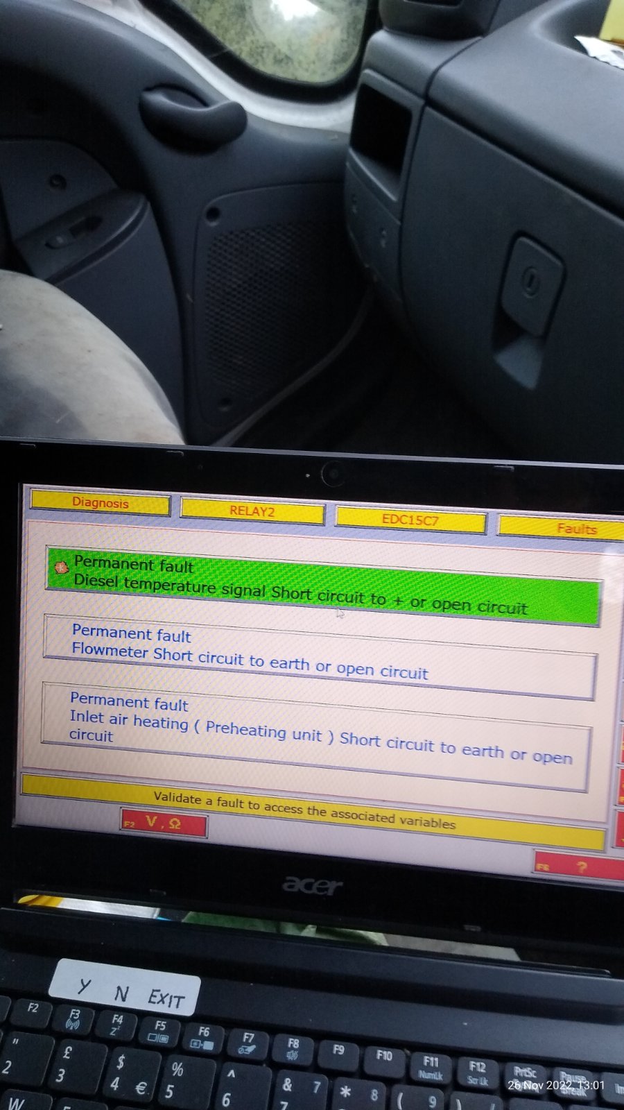

I now have a number of DTC's to deal with (see attached). I presume the one relating to the fuel temperature sensor (P0180), the first in the list, is the one giving rise to the engine light on the dashboard.
Any clues please as to how/where I might start my investigation? For starters, is the sensor likely to be under the bonnet, or (hopefully not) inside the fuel tank?

I take everything was OK with the chip once you done it off the rig & on the actual van?
Cant really remember about the vans but only the very early 2.0 HDi cars had a fuel temp sensor then they became obsolete on later models. They were on the fuel return line from the HP pump & had a 2 pin red plug, a quick check on servicebox & i cant see one listed either for your VIN.

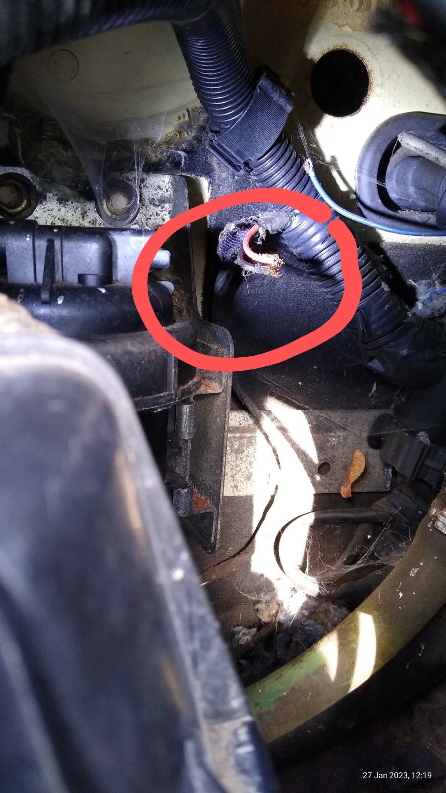

A rather belated update on this - apologies! It is a "background" project though!
The source of the "Diesel Temp " fault can clearly be seen in the attached pic!
The sensor cables had been completely chewed through. Piecing these out and reconnecting to the sensor plug cleared the dashboard light immediately.
With acknowledgement to forum member Wheeler -again!
