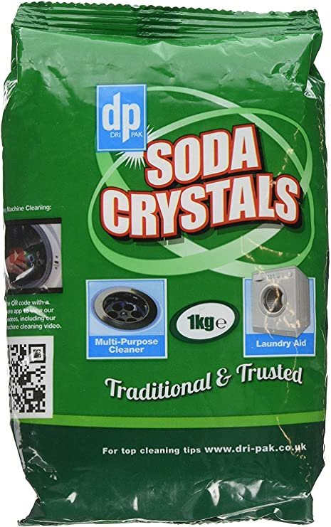

I'll ask my daughter in law but I doubt that she will know, she is of Chinese origin but British born, lived in Japan and I don't think she has been in China.
Maybe it is their version of this:
Six quid a kilo from Amazon, £1.70 from Home Bargains where I get mine.
Seen some for £12/10kg.

Had a closer look before sending her the video and it is Omo
