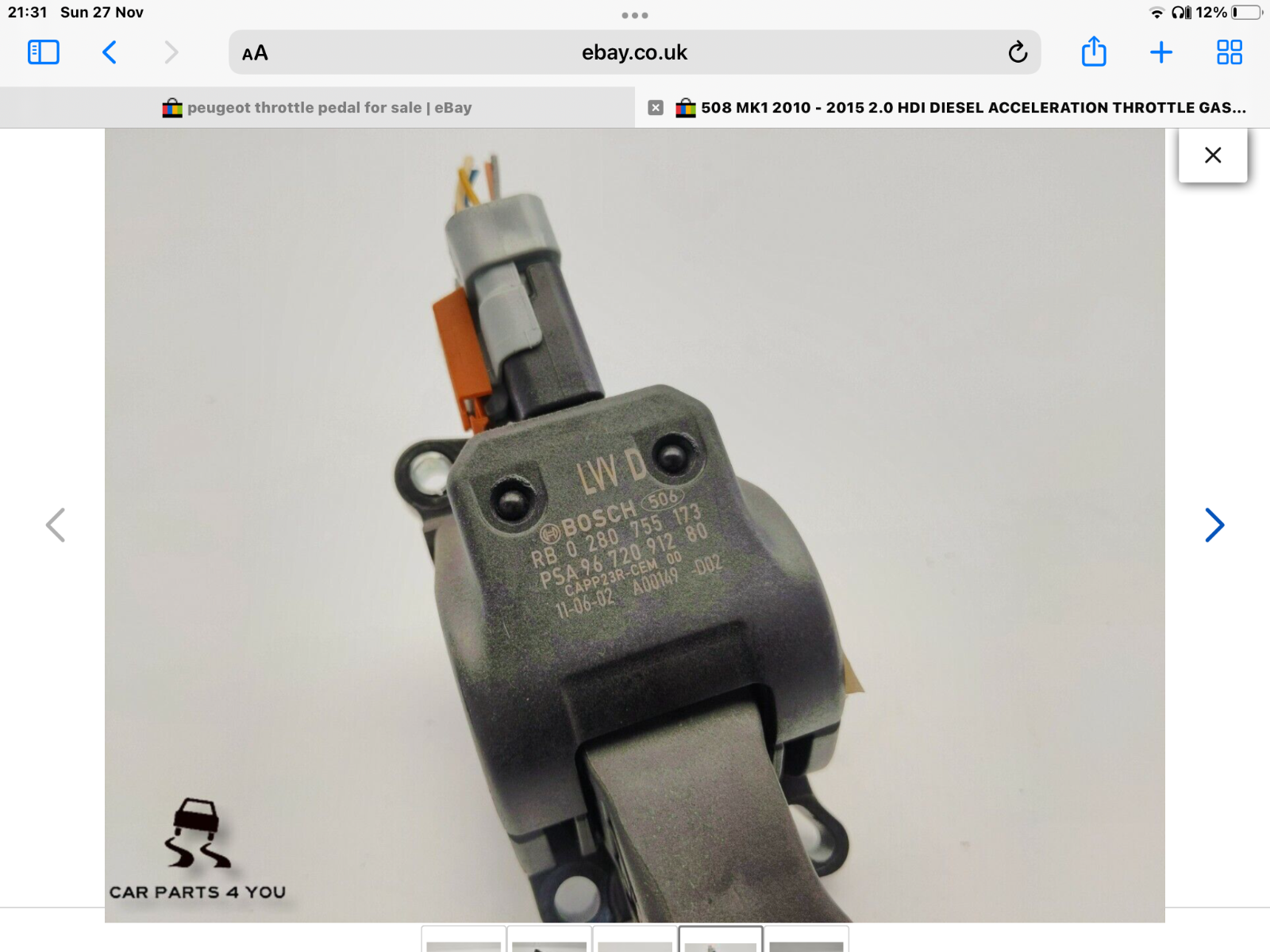

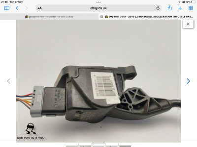

I was itching to get out and do some testing today but the did not allow cats and dogs all day. So I had a quick look about on EBay and the are plenty of second hand pedals so it might be easier to try a different pedal. So can anyone tell me what is the part number on this example picture as there are quite a few numbers but which is the part number ? Thanks
