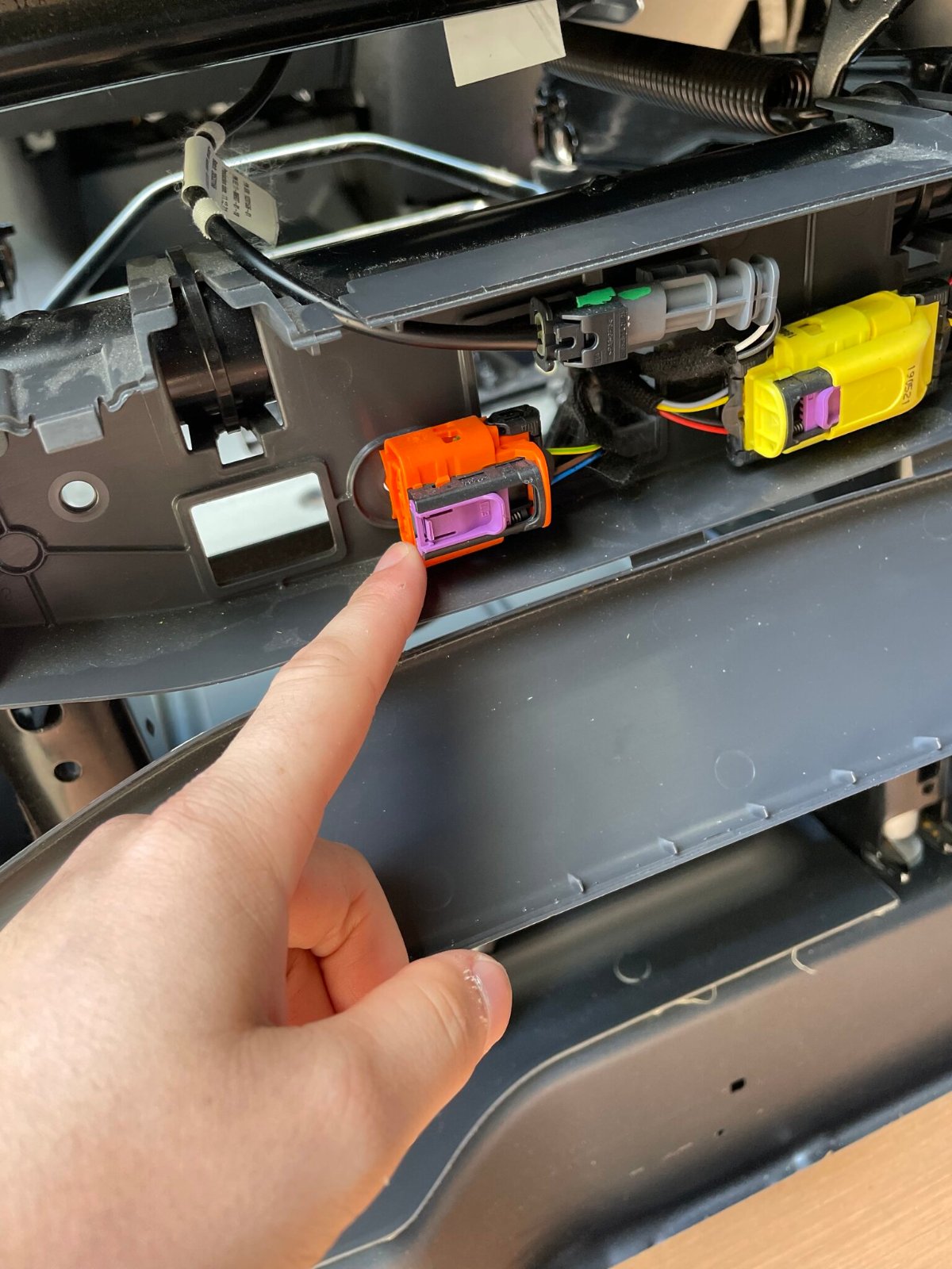

Hi,
I'm about to replace the double front seat in my 2022 Boxer with a single seat. Others who have done this have had trouble with Airbag warning lights because of seat belt pre-tensioners being disconnected. There's a red plug under the seat that I'd like to identify before starting.
I don't have a wiring diagram so can anybody tell me what it is? Are wiring diagrams on the Service Box?
Many thanks
Nick

I can't help you with wiring diagrams as it's a new model - Peugeot probably won't provide these to you and we don't have access to this data as it's very expensive for a subscription. Staff here can only help you with the parts data and parts diagrams and not the technical documentation unless we have it already.
I would say you need to be extremely careful about these as the Airbag ECU will no doubt be configured for the type and number of Airbags according to the vehicle seating and seat belts as it left the factory. You will get faults if you try and disconnect these and replace them with others units without the configuration update. This can only be done with the appropriate software, so likely a dealer or specialist job.
