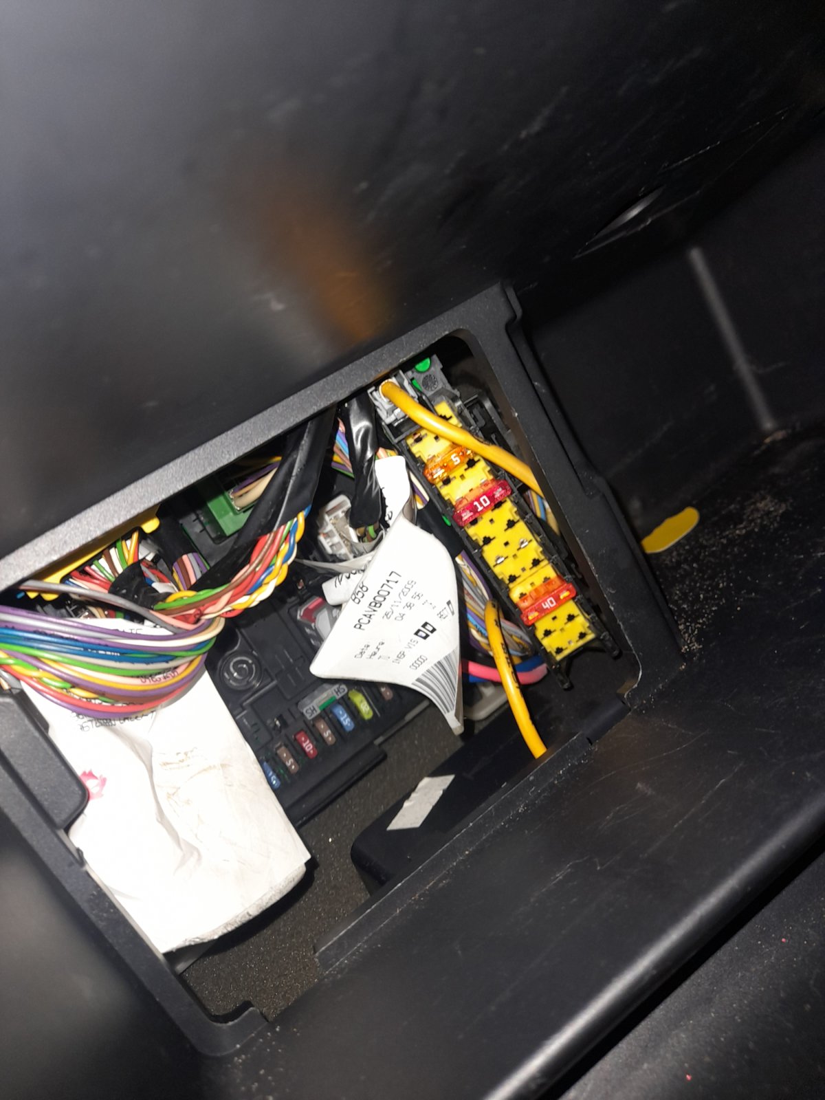

Hi Folks - looking for some help. Not sure if it's connected but spilt a considerable amount of coffee in the compartment between front seats on Friday and shortly after was told by a colleague that my brake lights aren't working (top brake light is fine). Bulbs replaced but also discovered fuel cap button isn't releasing fuel cap and no air blowing or buttons working on climate control panel (both located on dash to right of steering wheel beside driver door).
Checked lots of fuses but can't find any that have blown (glove box and beside battery).
Can hear a click from glove box when pressing fuel cap release button.
Any advice greatly welcome. Panicking about how I'm going to get fuel into it or keep the windows from fogging up while driving.

Problem solved - cause was stupidity. In my first attempt to see if any fuses had blown for cigarette lighter area coffee incident I must have put fuses back in wrong positions.
I now know which fuse controls fuel cap 5a and which does the climate control 10a on that single vertical strip on right hand side.
