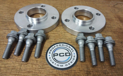

Hi, my Peugeot 306, just had its MOT, an advisory was the rear wheels are toed into towards the car and will soon be rubbing on the bodywork ! they suggested buying some wheel spacers. I have never heard of them ! where would I source them and what are they called ? thanks in advance Terry.

Spacers just move the wheels further outboard.
You can get them on eBay. Not sure how that'll fix the toe-in issue though?
