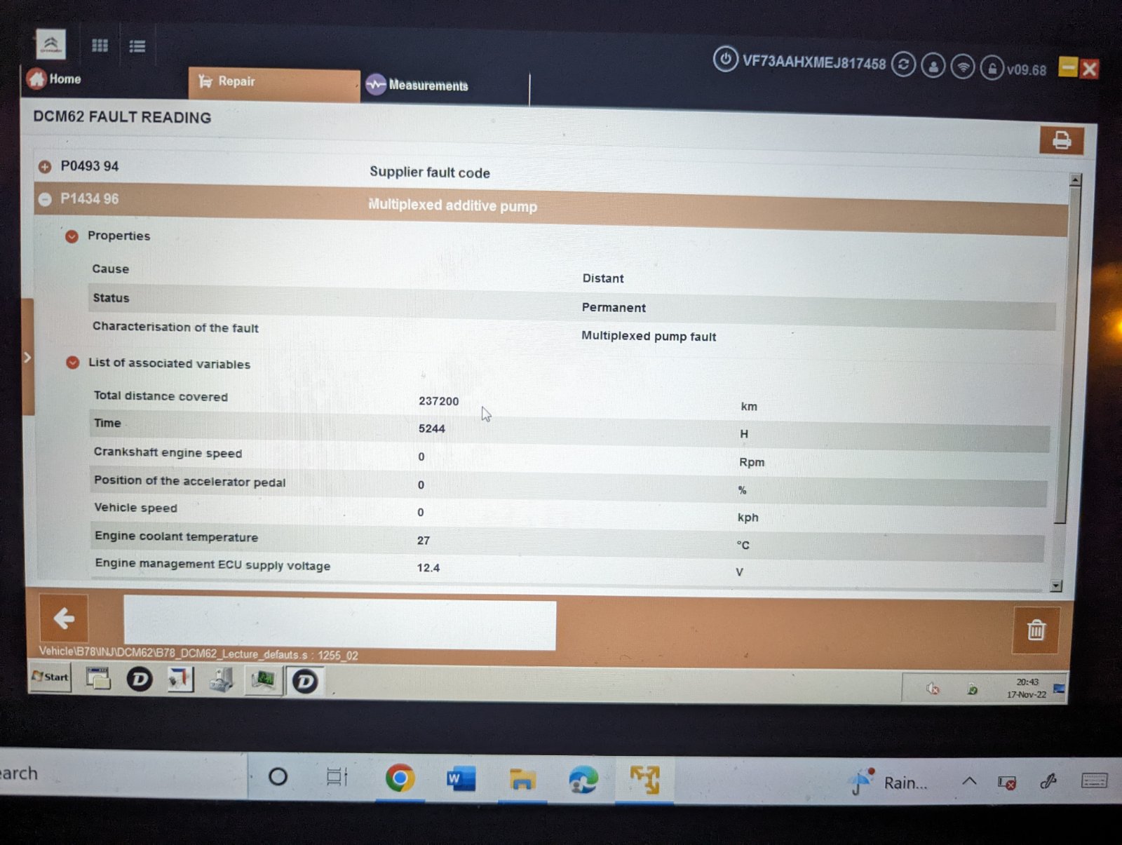

Running a new system scan the error for the fault seems to have gone but now I have another error in the engine ECU p1434 96 multiplexed additive pump
I read somewhere that it won't clear if there are other errors but literally I feel just entwined in it all!!

Is it possible to add photos on here? I can share an image of my errors then

These are 2 separate things.
Adblue has nothing to do with the DPF system.
Your other issue with the fault code relates to the Eolys additive pump that injects the Eolys into the fuel tank. This is reporting a fault with the pump, so needs investigation. If the pump has been dry running through lack of Eolys it will fail and ultimately need replacing. Either this or there is a faulty connection between the pump and the engine ECU.
Until the cause is investigated and the issue is resolved, it will mean only natural regeneration can occur and this requires a higher exhaust gas temperature (circa 550 °C, instead of 450 °C when there is Eolys mixed with the diesel), which typically means long journeys at higher engine revs to ensure the exhaust gasses are hot enough to trigger regeneration.
- Adblue is used for the SCR (Selective Catalytic Reduction) system and is injected into the Catalytic Converter to treat the NOx.
- Eolys is stored in a separate tank and is injected into the fuel tank whenever you add fuel and helps with regeneration of the partilcle filter by lowering the exhaust gas temperature at which regeneration occurs.

Hi, sorry for the delay. So I am still debating this. I can buy a new part for £150 or a second hand one for £90. Just a bit nervous that I buy it, fit it and then it still isn't right. What do you think?
This is the part https://www.neobrothers.co.uk/car-parts ... 1610115580
- x 6945
Re: C4 grand Picasso diesel additive reset
That's a chance you'll have to take, but that is the correct part number. The replacement will need filling, priming and the additive counter resetting too and then errors clearing.
Are you getting any issues with the radiator fan running at fast speed or any warning / service messages when the A/C or Heating is activated? The reason I ask is that P1434 has been known to come up along with P1435 (both additive related issues) if the radiator fan electronic control box is faulty. If this is the case it may be worth checking first.
