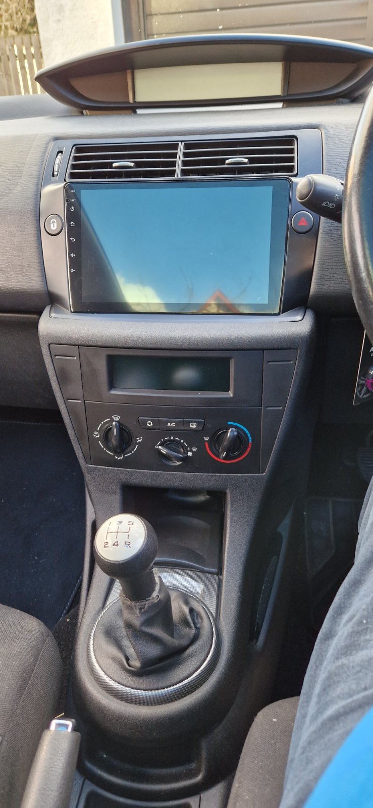

I have recently replaced the RD45 radio with one of the Chinese 9" Android head units. It came with Raise canbus decoder and installation went fine.
The only issue is that the speedo keeps switching between kilometers and miles. I have tried selecting 307 from the list which works fine, however only volume button work on steering wheel.
Has anyone experience this before? The Raise canbus is PSA-RZ-15.
