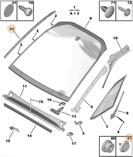

They probably should have fitted new clips when replacing the trim. The trim is secured onto the underlying clips which are sold separately I think:
(20) is the trim
(81) are the clips

Do you know how to remove the A-Pillar trim? (Part 20)
I think there is a screw in the upper inside front door roof - but not certain

Looks like there is a bolt under a cover just at the top front corner of the door - says to remove a plastic trim cover first. Then 6 clips holding it on down the length. Clips should be widely available, I'd just get some and fit them, easier than taking it back!

Do you know the part number for 81 shown above?
The parts website I use does not list that one, and only goes upto part 80 for the windscreen section;

Part: 812396, £2.32 each
