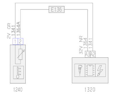

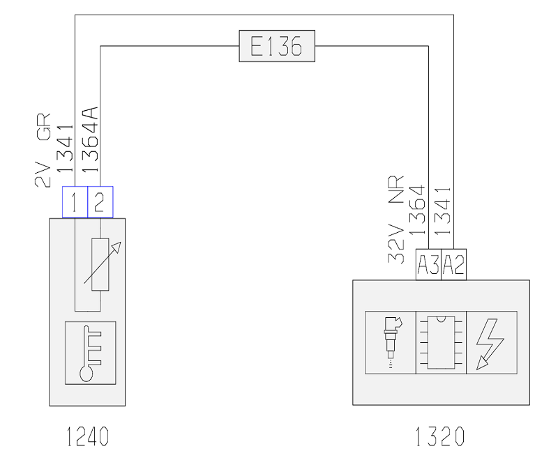

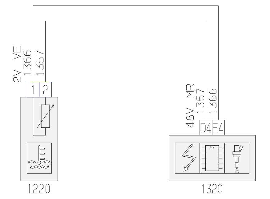

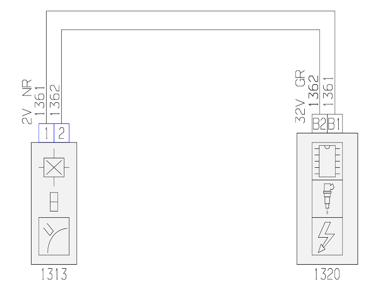

Hello
I am in need of the wiring pin outs for the crank sensor and the cam sensor for the EW10J4S engine.
Vin number VF3**************[VIN obfuscated, can be read by forum staff]
Also could use pin outs for the oil pressure sensor, coolant temp sensor and Intake temp sensor if possible
Thanks
x 6961
Re: 206 gti 180 cam/crank sensor diagrams
Engine Speed Sensor
Induction Air Temp Sensor
Engine Coolant Temp Sensor
