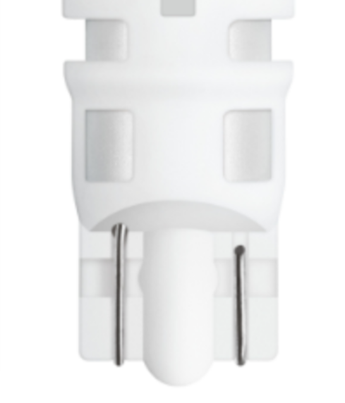

Are they full lamp units or LED T10 / W5W?
If the latter, and are similar to this: Then I have found it very easy to end up with the bent wire contact to be "next to" rather than "trapped under" the bulb holder's contact. Given the low current it tends to work ok, until any tiny vibration causes continuity to be broken. This is often fixed, or shown to fail, under a bit of "percussive maintenance".
Note I've no direct experience of the OSRAM LEDs shown above, just a suitable picture with bulb base looking like the cheap eBay versions from China I tend to buy
I'd take the LED bulb out again and see if you are suffering the same issue,

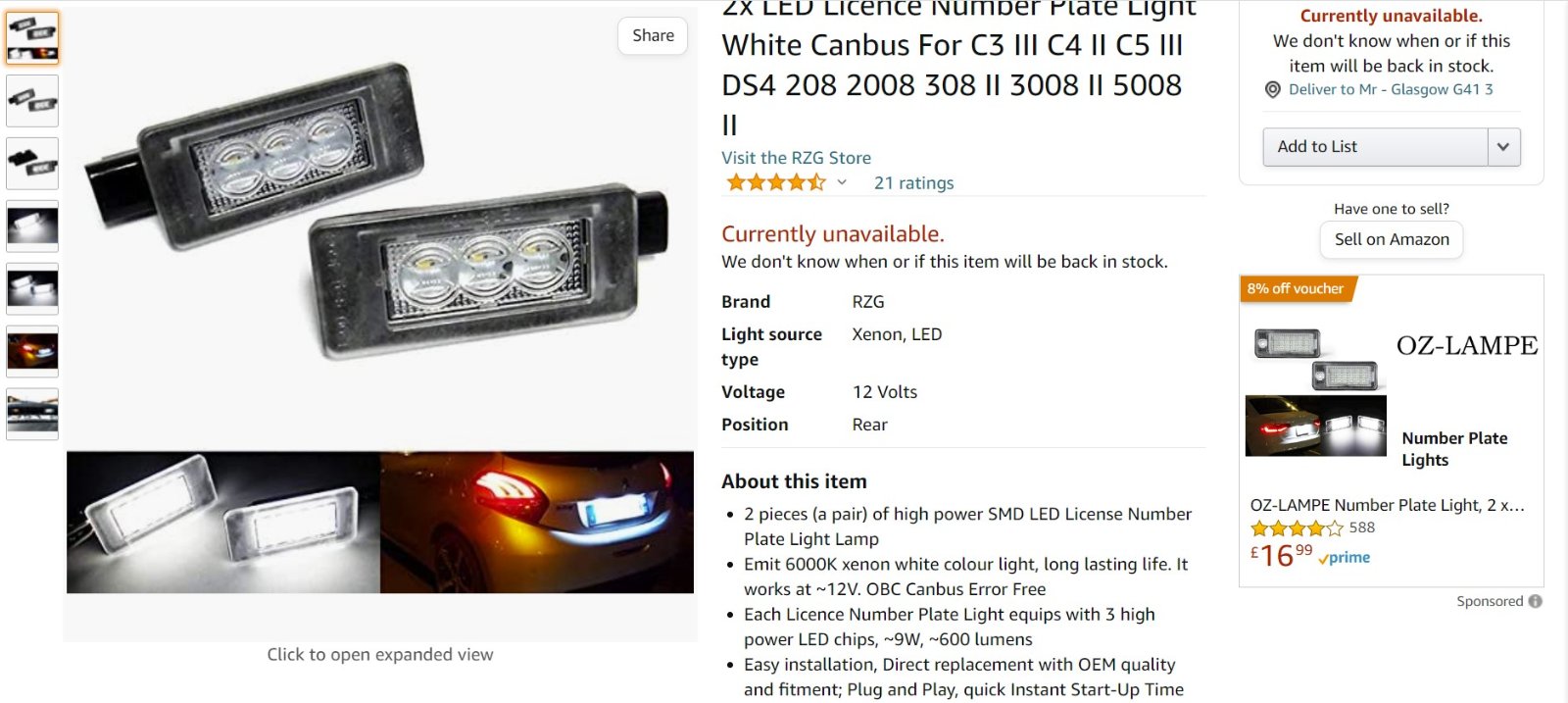

Hi folks, they're full led units - a full lamp fitting and not only the bulb.
Yea, I had a fear it might be the wires going through the rubber tube .....
But I'm gonna try Jay's suggesting first!

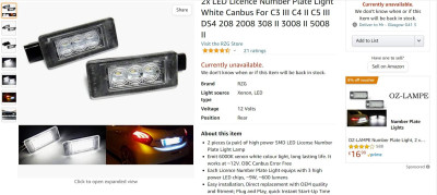

These are the ones I got:
They're full light fittings (my old ones were in some state..) and to be fair, they've been really good - proper bright and never flicker. They are supposed to function with the part CANbus system. I had originally fitted only LED bulbs in the old bulb holders and I got the same as you, flickering. I transferred them to the boot inner lights and they have been great. They only flickered when the engine went off and the lights remained on for 10 sec or so. I assume the voltage drops for a period just before they extinguish.
I would have thought that these led fittings would not upset the test lamp feature (not sure my car actually has this anyway because it didn't know the brake lights were out or the old number plate lights) because they have the correcting diodes in them already.
Knowing my luck it'll be the wires through the hinge of the hatch.

Yea, I honestly chose those ones specifically because all the reviews reported they worked well. They're seemingly still working OK - not sure what happened the other day. They might have staked but the trouble is I don't know when in my journey that day - I only noticed they were not lit when I stopped and got out with the engine still running. Gonna try the off-on test next time

Also, they're purpose-built for the C5 and other PSA cards that use that shape of lights. Just plug straight in. They do seem to be decent quality. My car's original lihht fittings were in a bad state so really needed to be replaced anywayKennyW wrote: 16 Nov 2022, 10:17 Graeme,
