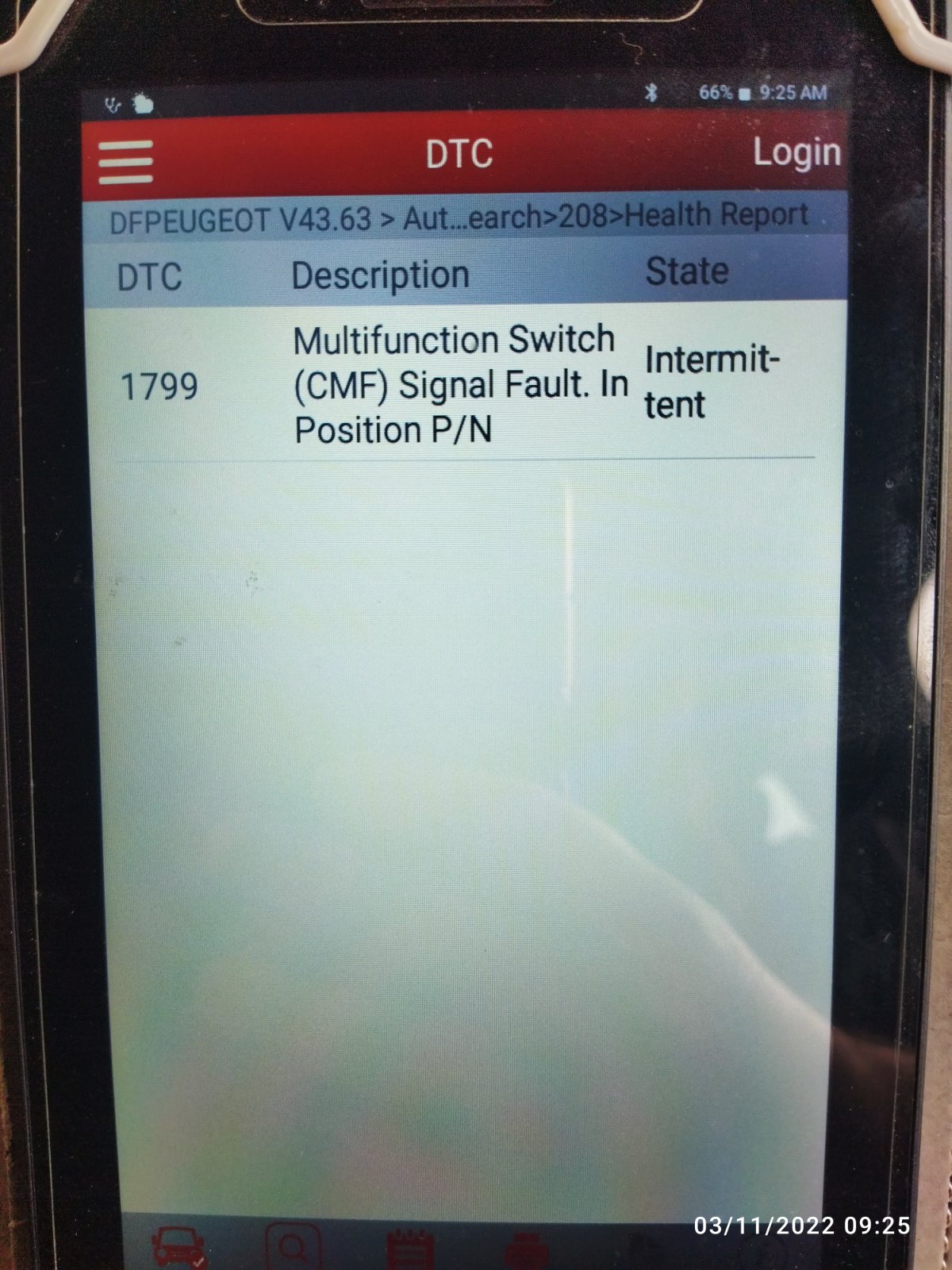

I got an P1799 multifunction switch fault (see the pic).
I can't really find info about, but is possible the gear selector sensor?
The fault isn't always there because of being intermediate fault, however the dashboard gives me always: gearbox fault repair needed and my service light is on and not deletable.

This is the fault descriptor for your specific vehicle with AL4 box Yafi:
| Fault Code: | P1799 |
| Description of Fault: | Multifunction switch signal fault - Park/Neutral switch : Not characterised. Fault: Contact Park / Neutral Detection threshold - Possibility 1: Park / Neutral switch inactive - Possibility 2: Multifunction switch not in position Park Fault confirmation time: Immediate. The following conditions have to be met: - Ignition on - Moving of the selector lever - Battery voltage between 10,5 and 16 V |
| Conditions for Fault to clear: | No rehabilitation possible. |
| Downgrade Modes whilst Fault is active: | Switching on of the warning lamp and/or warning message): Warning lamp SERVICE, Sport warning lamp - Snow warning lamp - Warning lamp for automatic or 6-speed piloted manual gearbox (Orange PRND triangle) - Display of a "-" on the fascia panel (these depend on equipment) |
| Symptoms: | Starting impossible |

@givemeabreak: thanks for the detailed description of the fault. I can't actually say that there is a P/N fault at all.. the sport and snow lamp doesn't give a signal fault either as it's mentioned in the description. I'm really clueless. I bought a gear selector sensor in the beginning of the year (it's from the same car I bought the gearbox from), do you think it's worth just swapping it?

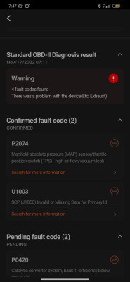

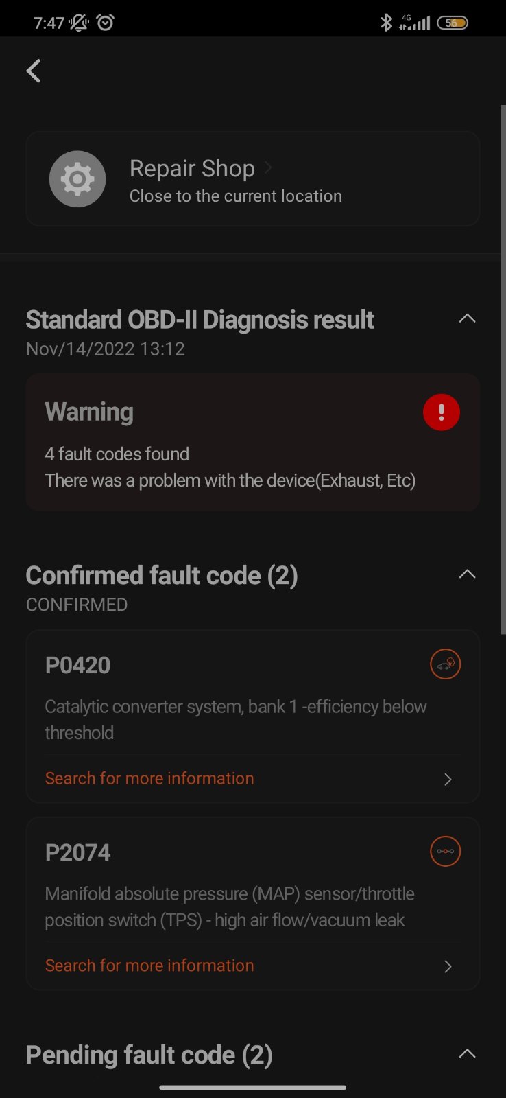

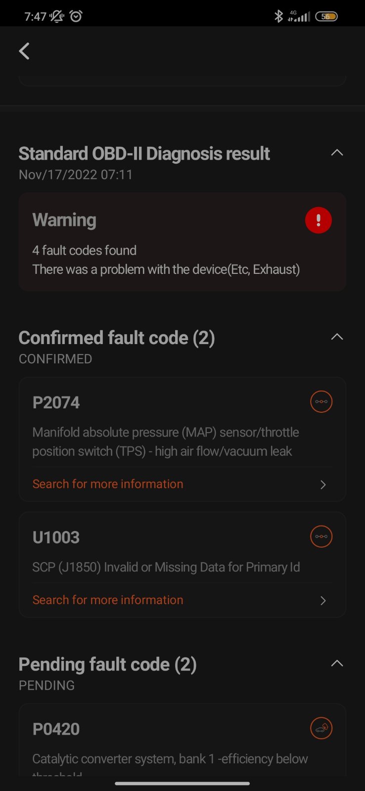

Since I replaced the second oxy sensor the car gives me the fault (MAP and TPS fault)of the attached screenshot.. gonna go tomorrow for it and see what's up with that. The catalytic converter might need replacement or was actually taken out as well, no signs of it from the outside though..
