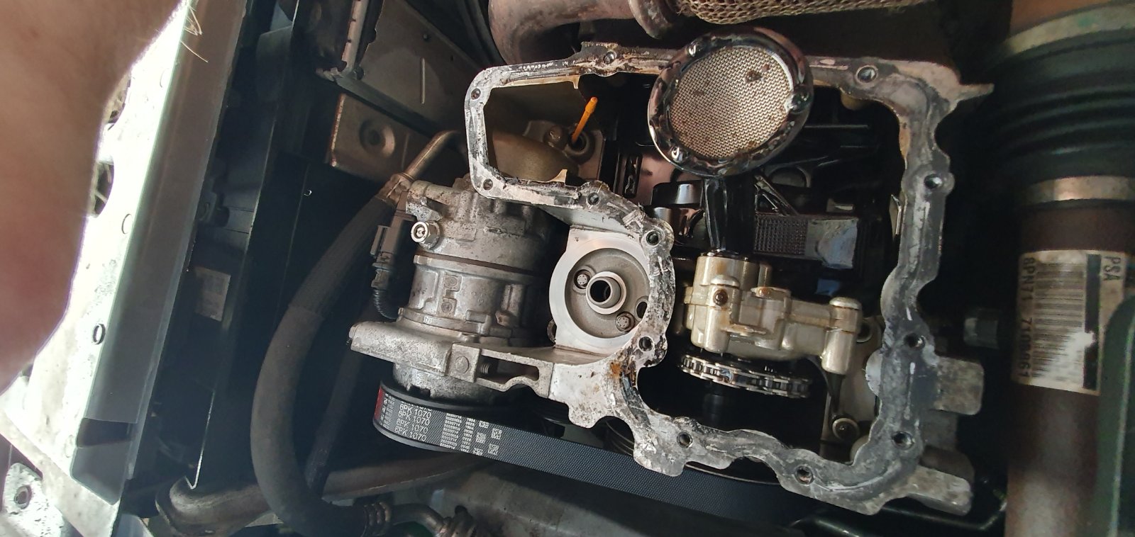

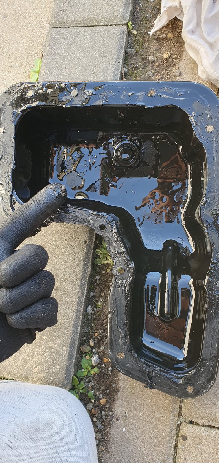

To rule out the possibility the engine shop mentioned, I took off the sump pan today and all clean inside, and the oil pickup was clean so, it's definitely not the belt degrading and clogging the pickup.
Once the gasket seal is cured, I'll refill with oil and test at high revs with the PCV disconnected.

Looks beautifully clean in there!
