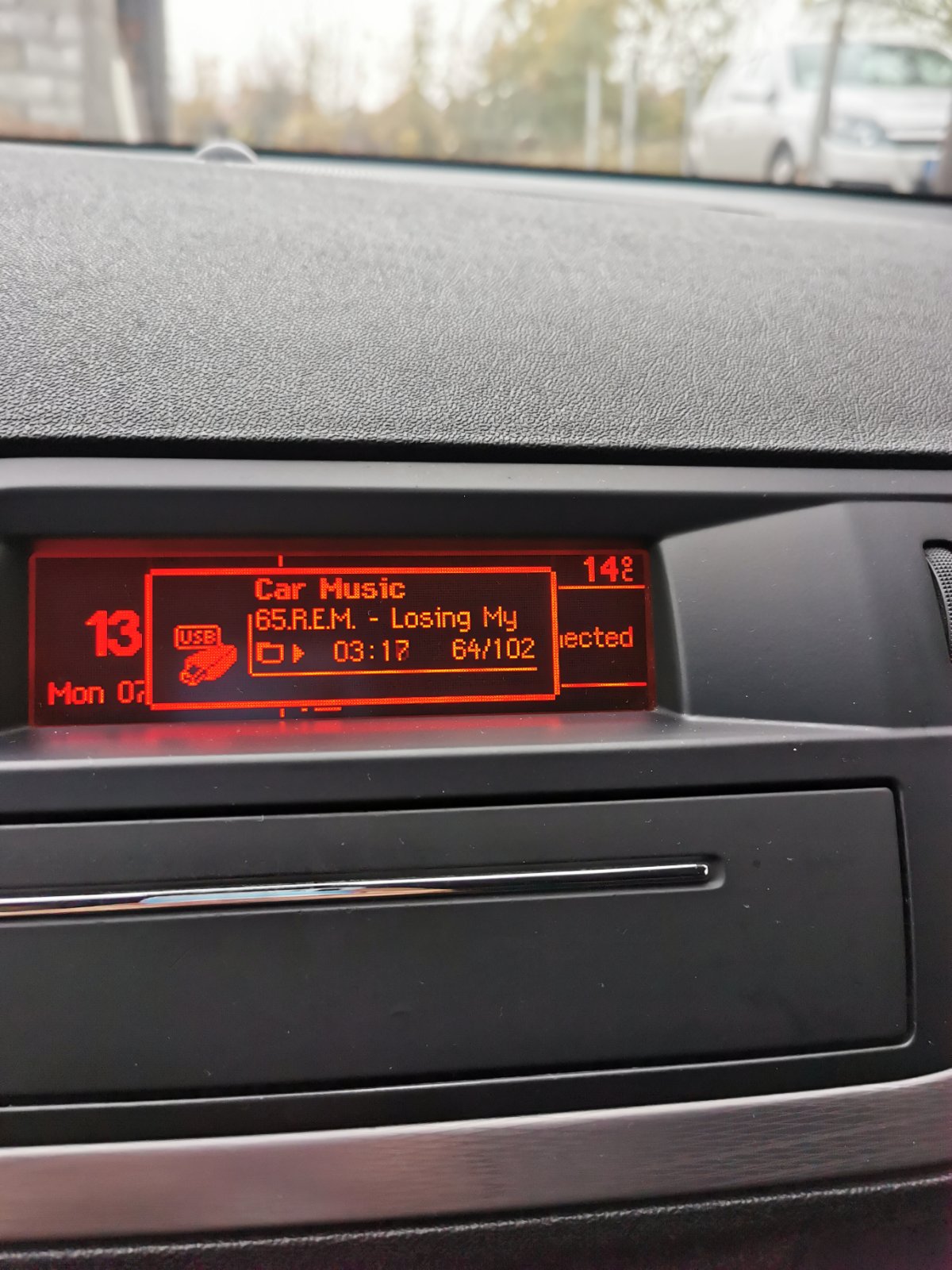

Hey smart people of french car forum.Got one issue related to Bluetooth connection or rather annoyance.While still deciding weather or not i shoud buy android am stuck with tiny matrix display and something aint right with screen display.
I mainly listen to music on usb which is connected right next to cup holder in center console.Now every time i turn on car i get like 10 to 15 sec of correct display where music playing is shown,track number,time remaining etc. But after time i get 'error' saying Bluetooth not connected as if it's trying to connect automatically all the time.
How it should look like.

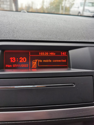

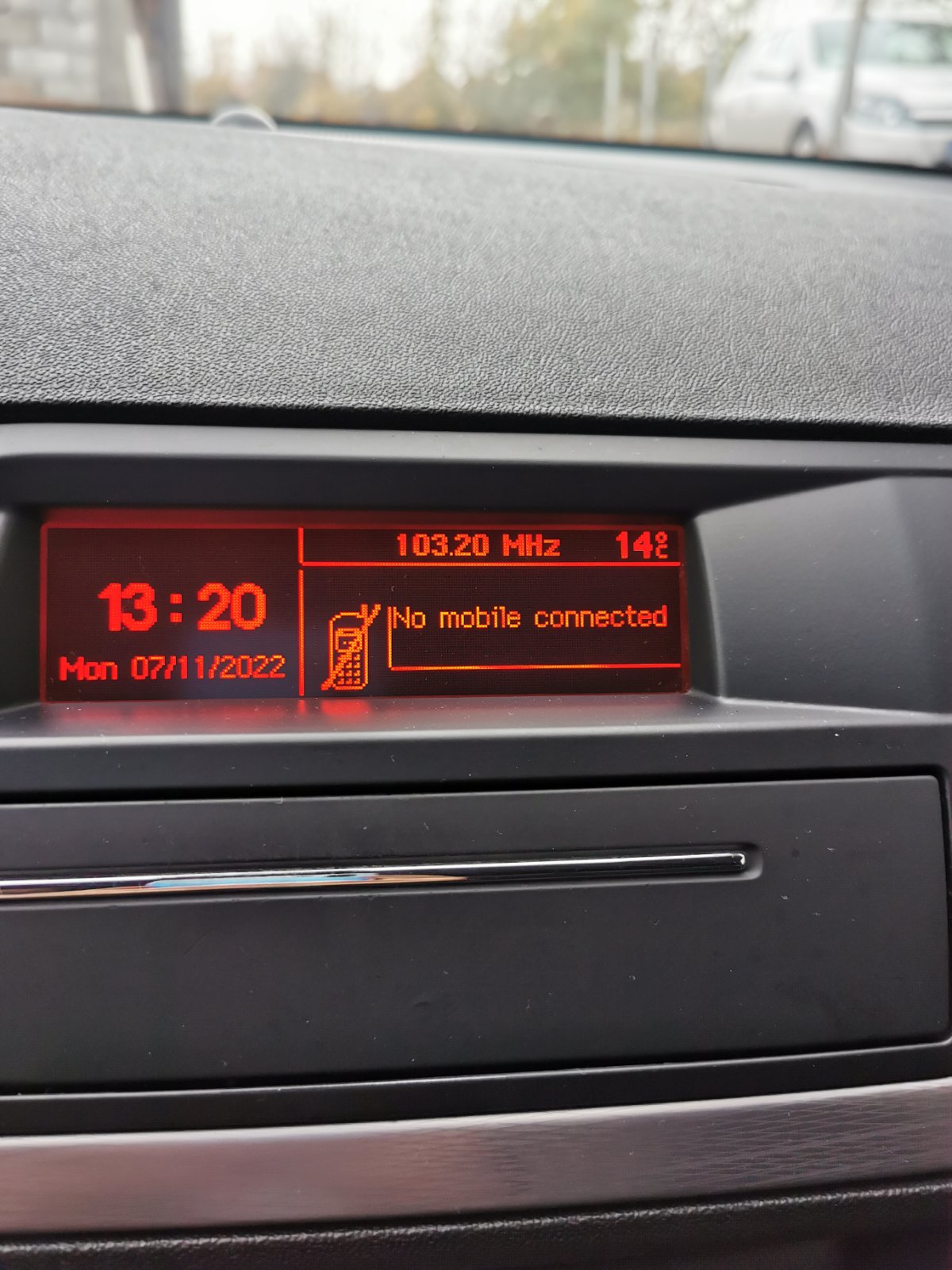

But i get this after 15 sec
So it looks like that normal radio/usb scren overlaps bluetooth screen for a bit then bt not connected is all i can see.Hope i didnt make this too complicated.
x 6950
Re: Citroen c5 x7 Bluetooth not connected error rd45
Well it looks like it is trying to connect to a previously paired mobile that is no longer available. To get rid of this, unpair and remove all previously paired phones. Then just pair the one phone you use. That should stop it trying to connect all the time.
