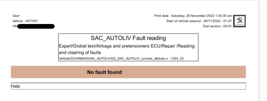

So had another airbag fault come up last night so fired up Diag but no error found.
A air bag error even came up (and went away) during running global test and still did not register any faults. Have I missed a page ?

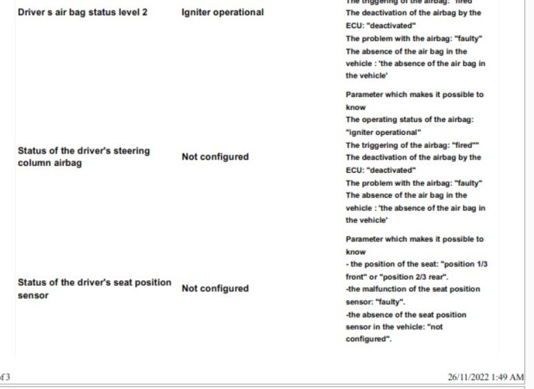

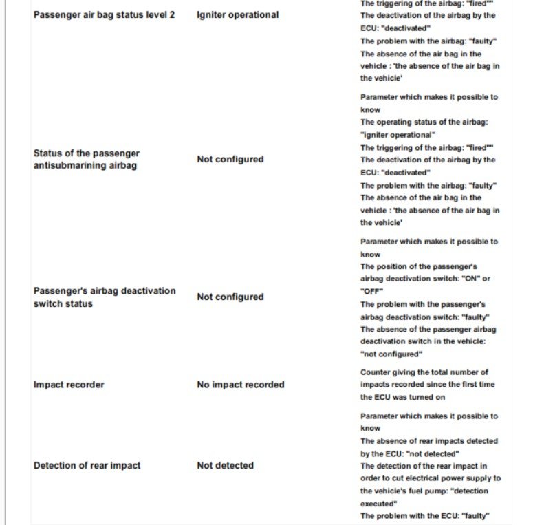

I did notice some "not configured" values on some items in SAC_AUTOLIV Front airbags pages which seems strange, eg Status of drivers steering column airbag, status of drivers seat position sensor, Status of Passenger air bag deactivation switch status.

Really strange you dont have a fault code even though the light was on, I would maybe try it through PP2000 rather than diagbox.

And be aware that your vehicle does not have a driver's knee airbag that is attached under the steering column, so that is probably correctly configured, so is the option for Airbag deactivation - which is also not supplied. Although you may have a manual key operated switch, so I would leave the configuration for this as it is unless something has been changed.
