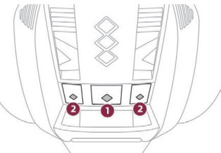

Hi all
Just bought a DS7 2019 model
ATM its been outstanding
I having a problem with the Interior light ,it doesn't come on when I open the door, and I can't find where to activate it
any help much appreciated
thanks
Interior Light
- x 6955
Re: Interior Light
Yes, on this vehicle, the courtesy lamp is deactivated with a long press on the lamp itself shown at (1) below and a symbol should be displayed somewhere to indicate it is deactivated.
So to reactivate it, another long press on the lamp should re-enable it.
