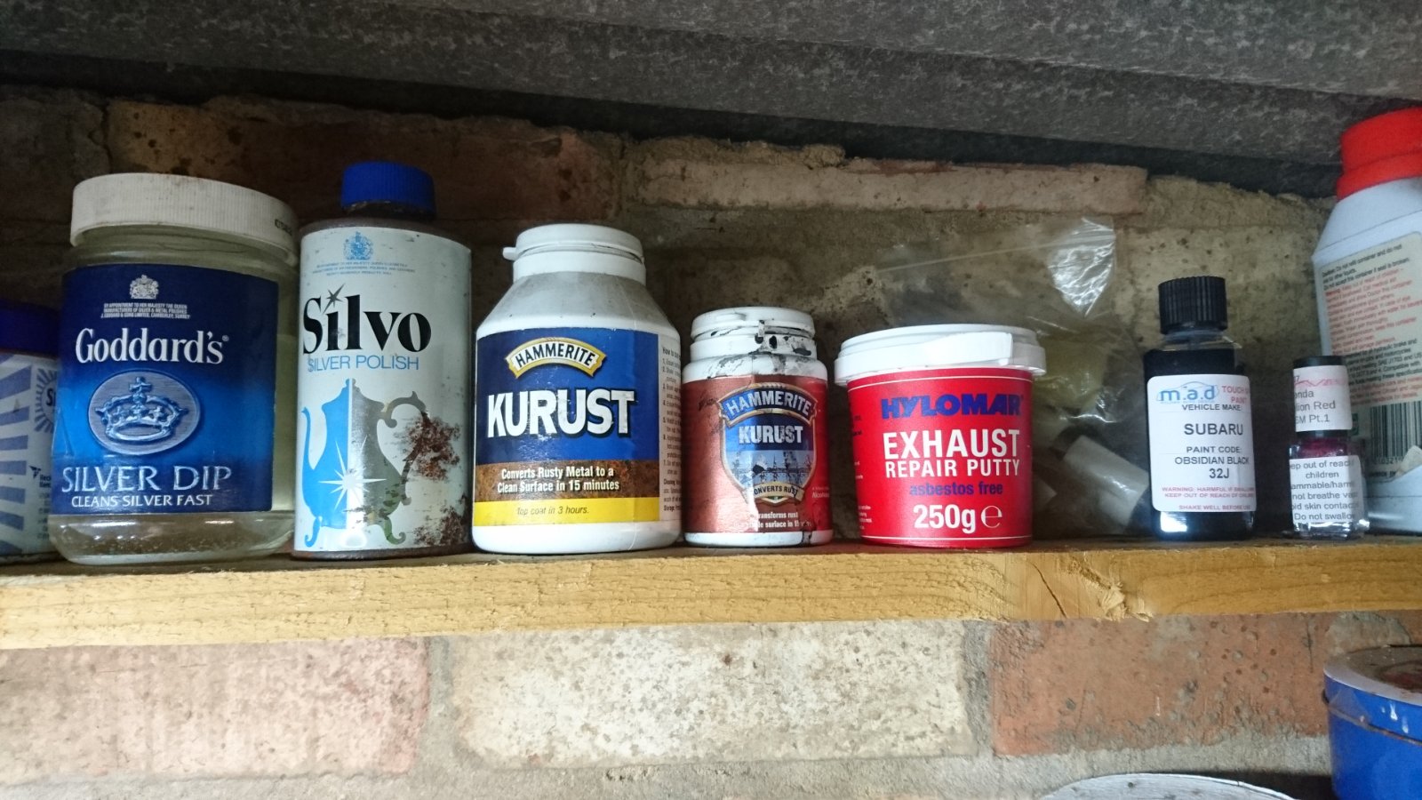

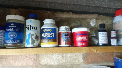

I still use Kurust now, I have two pots in the garage, still works for me as the same bit of Kurusted corrosion on the MX3 has remained solid and passed the last three MOT's without further attention!!

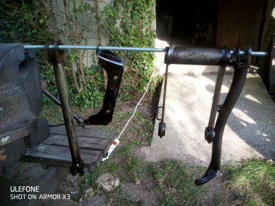

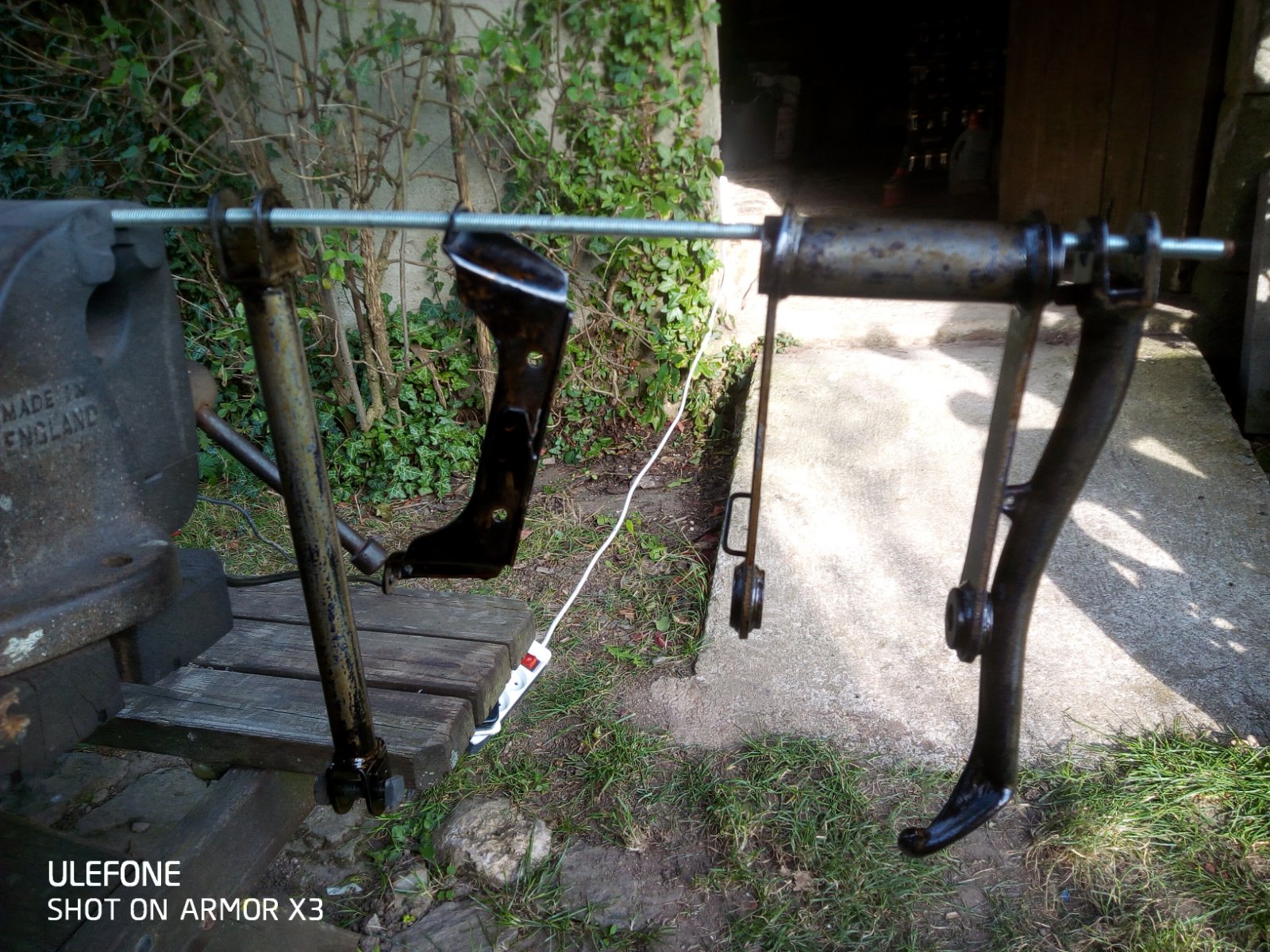

I've got some FerTAN. It's very thin, needs to be left for 24 hours, can be left unpainted for up to 6 months, can be recovered. It contains some nasties so don't drink it or chuck it down the sink. My brother has a barge and all the boatyards use it.
These are some bits that I wire wheeled back to base metal ready for painting. It can be used as a primer. It turns black, violet when done, needs rinsing in water afterwards and can be used even if the to be treated area is wet.

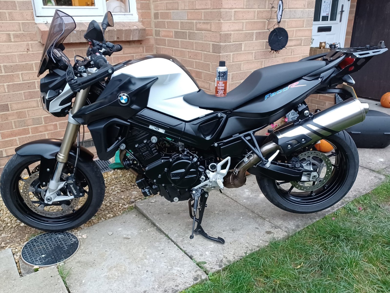

I use XCP Rust blocker on my bikes. Gave it a proper clean and rust-blocking today. Now I don't have to clean it over the winter, it can stay filthy
