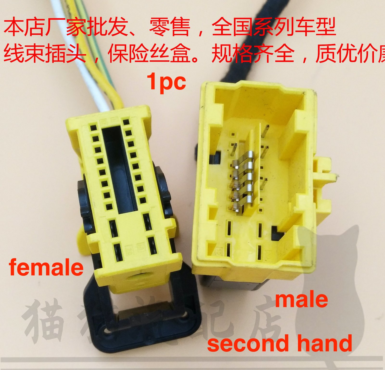

Seat female / male connector:

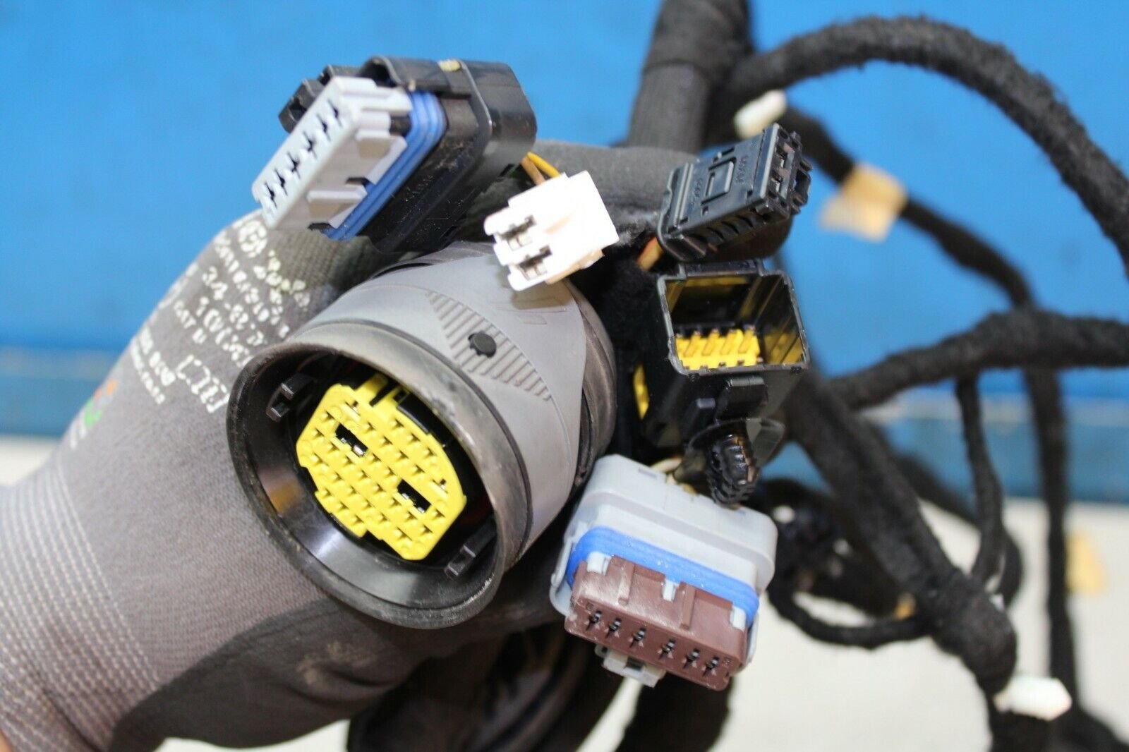

Door female connector
Door male connector
(still looking foor a clear picture)

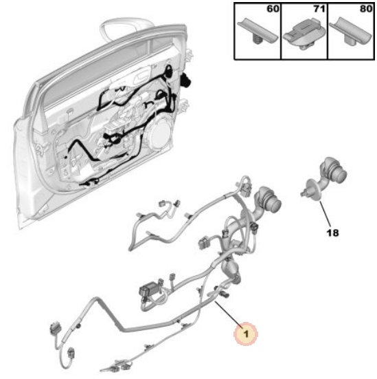

These are the door harnesses for your X7 that I think you want. You may be able to get the plugs themselves separately, but these are the complete harnesses.
Driver's Door, part: 9675031080, £255.86
Passenger's Door, part: 9675031380, £249.00

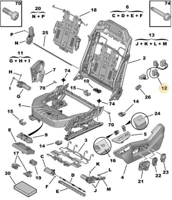

Driver's Seat Harness, part: 6505A2, £119.05

I had a good look through the repair connections catalogue & cant see these listed. The seat plug looks like special airbag connections (designed to short when disconnected) so unlikely these would be available anyway.
As for the door harness, pretty much all of the other connections & terminals are available separately apart from the main round one. On older PSA cars with the twist type door to body connectors these are available as separate terminal but not on that newer slide lock design.
