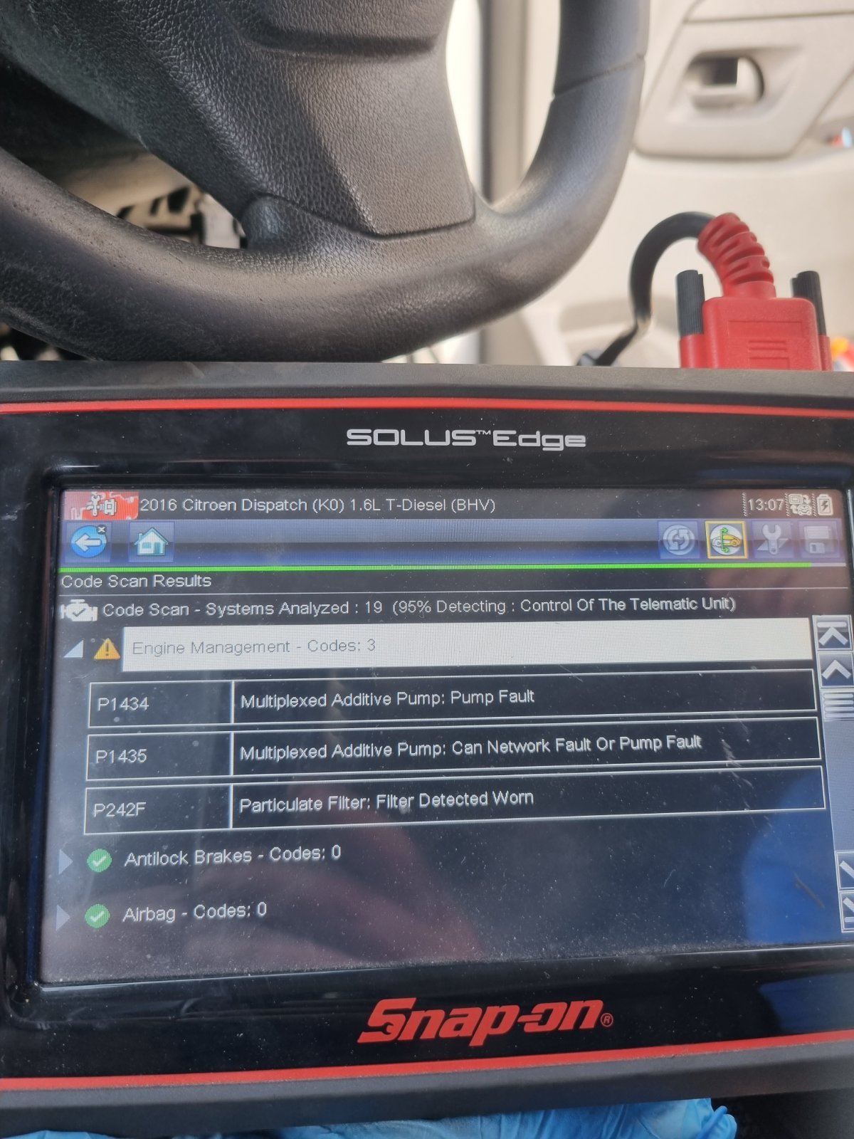

Hi I have 2 dispatches with these fault codes in any ideas what they are? They both came on after filling diesel
p1434 p1435 p242f

Any warning light/messages on the dash? What are the mileages?
Reading between the lines it looks possibly the additive system isnt working correctly (possibly pump failure) leading to clogging of the DPF.
Might want to drop the DPF off & get it cleaned first, this may at least allow it to pass smoke test then deal with the additive pump fault.
