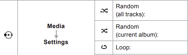

Re: MP3 Play Order
Ok, so just confirming you have the 7" Touchscreen system (SMEG).
So when selecting your source and the USB, look out for these options:
These will control the play order when active.
