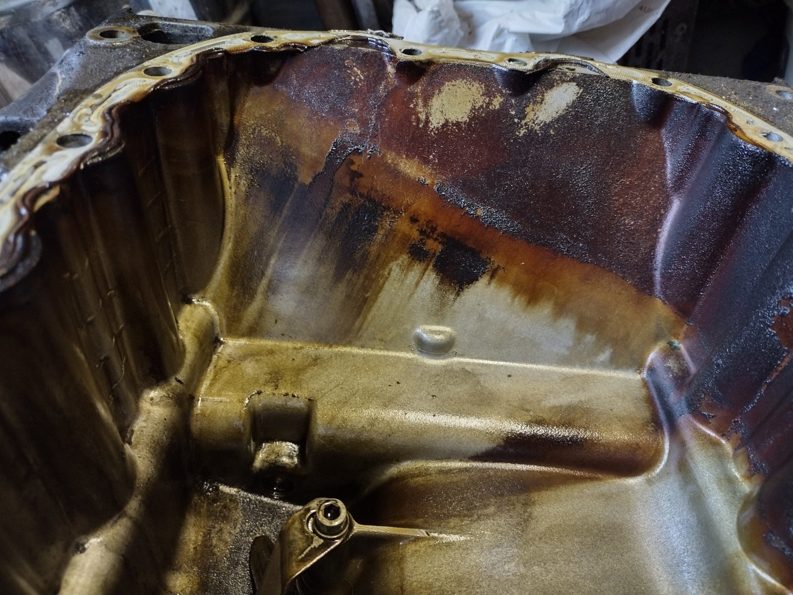

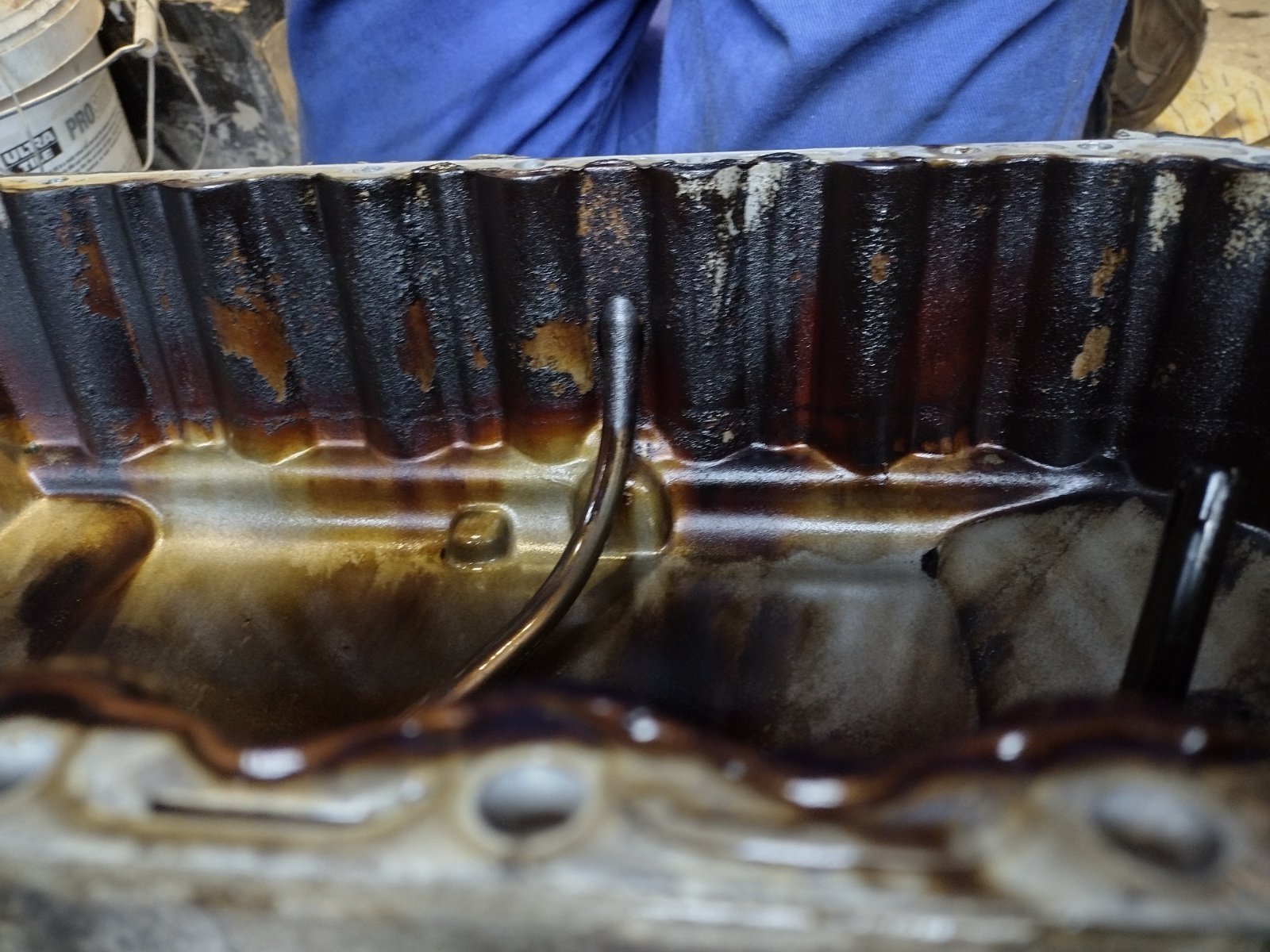

I have an engine on a stand, bought cheap on eBay (£80!) Mileage unknown, believe it's an 2006-2007 vintage. Do know it's from a 307 and is an EW10A (or as per data plate is actually an EW10AF)
Ultimately I plan to fit this in my 2000 406 Coupe in place of its current, somewhat tired EW10J4 (169000 miles covered)

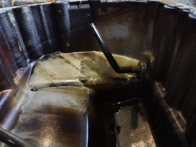

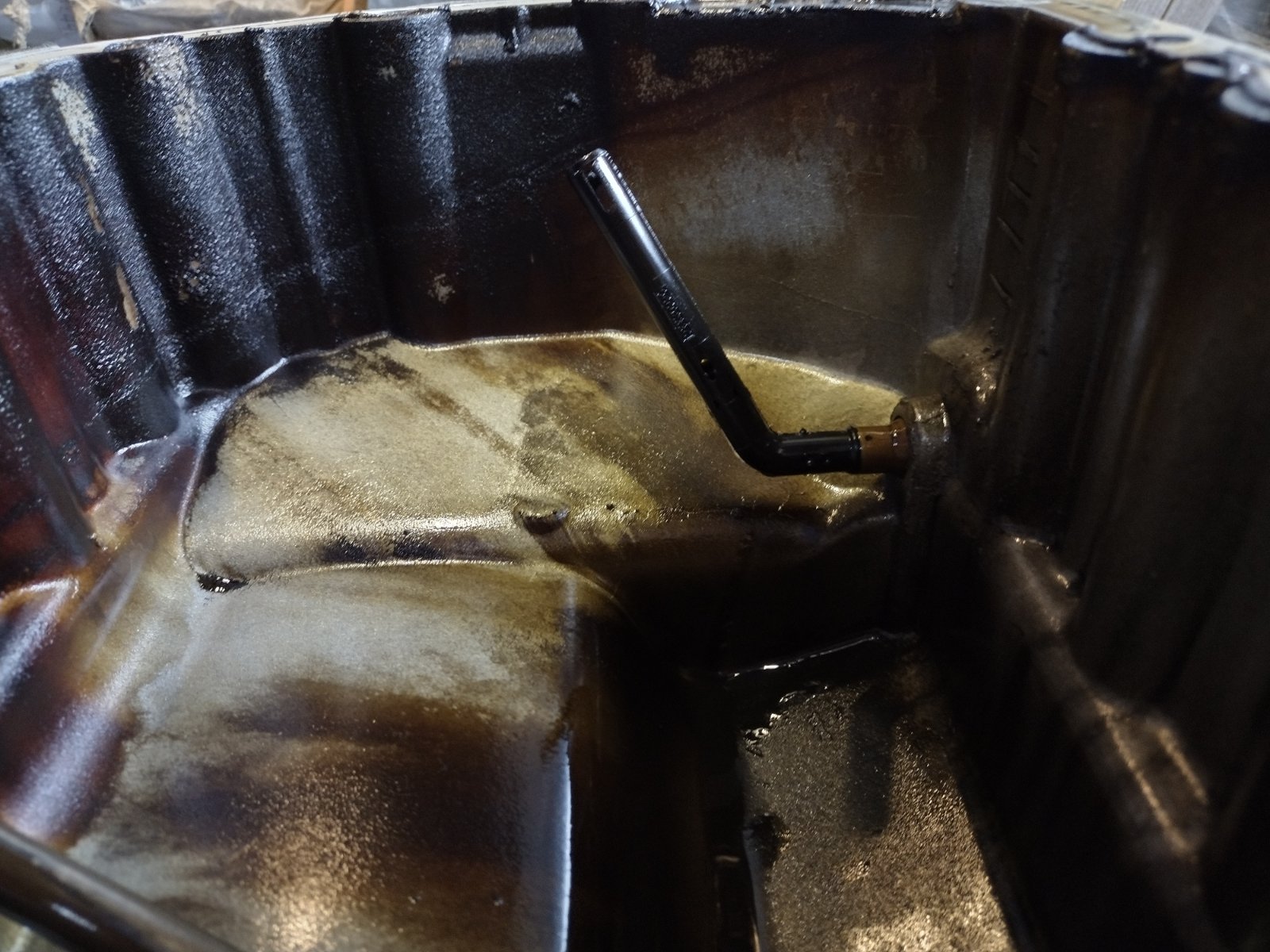

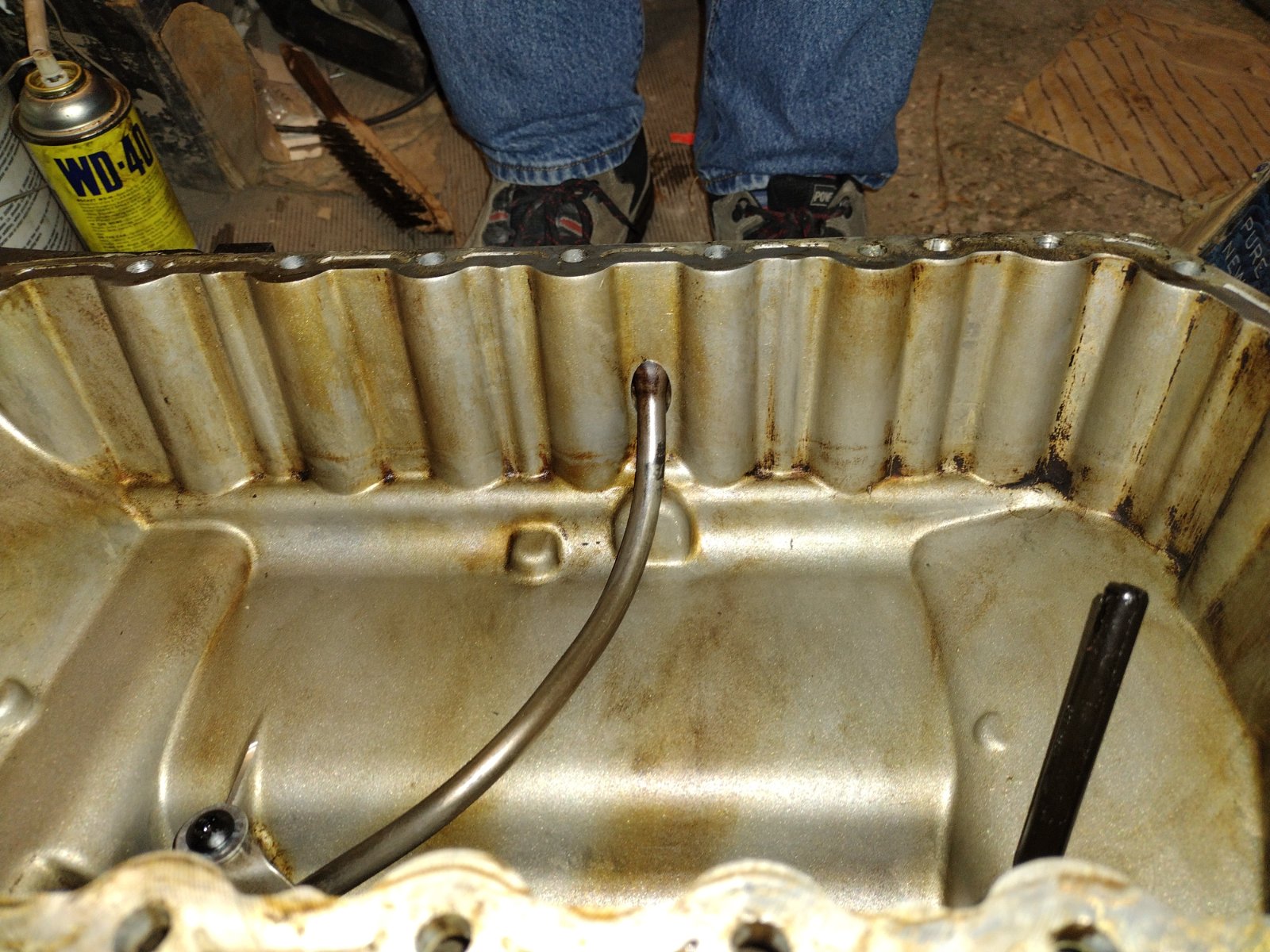

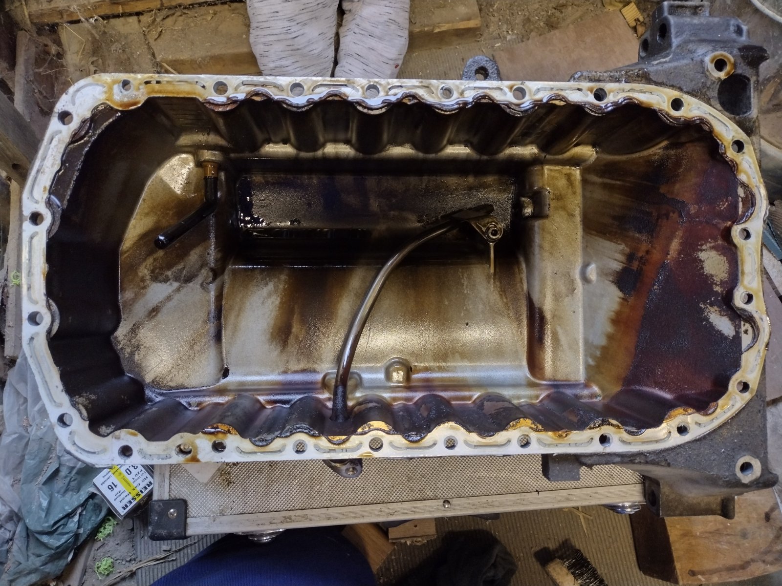

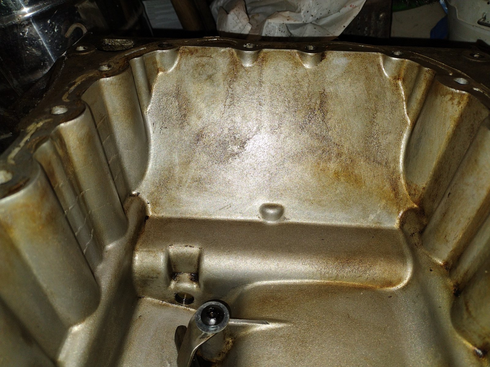

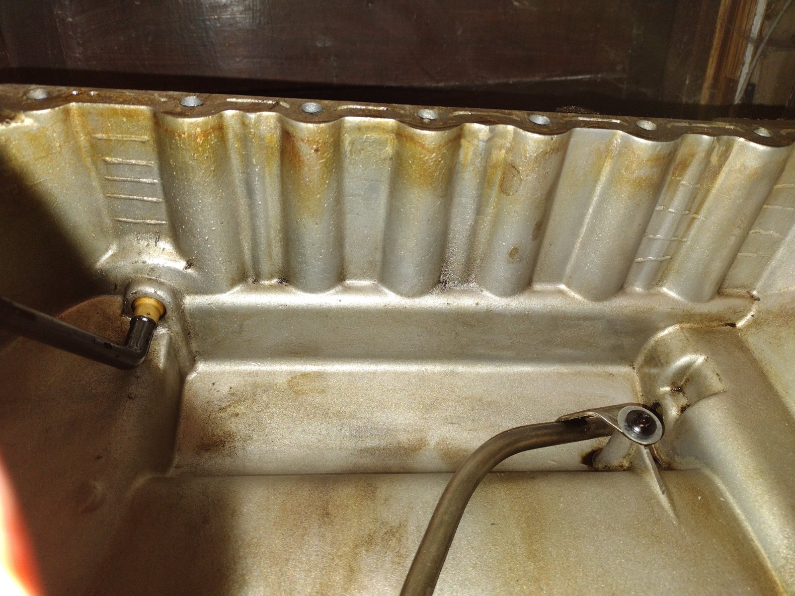

Sump off for a clean up of the "new" engine. Here's a few before and after pictures
Before
Before
Before
Before
Before
Before
Before
Before
Posts: 5237
Joined: 25 Apr 2022, 09:03
x 2297
Re: If you ever needed convincing cleaning out the sump was a good idea (307 EW10A 2.0 petrol)
Unread post by MattBLancs »

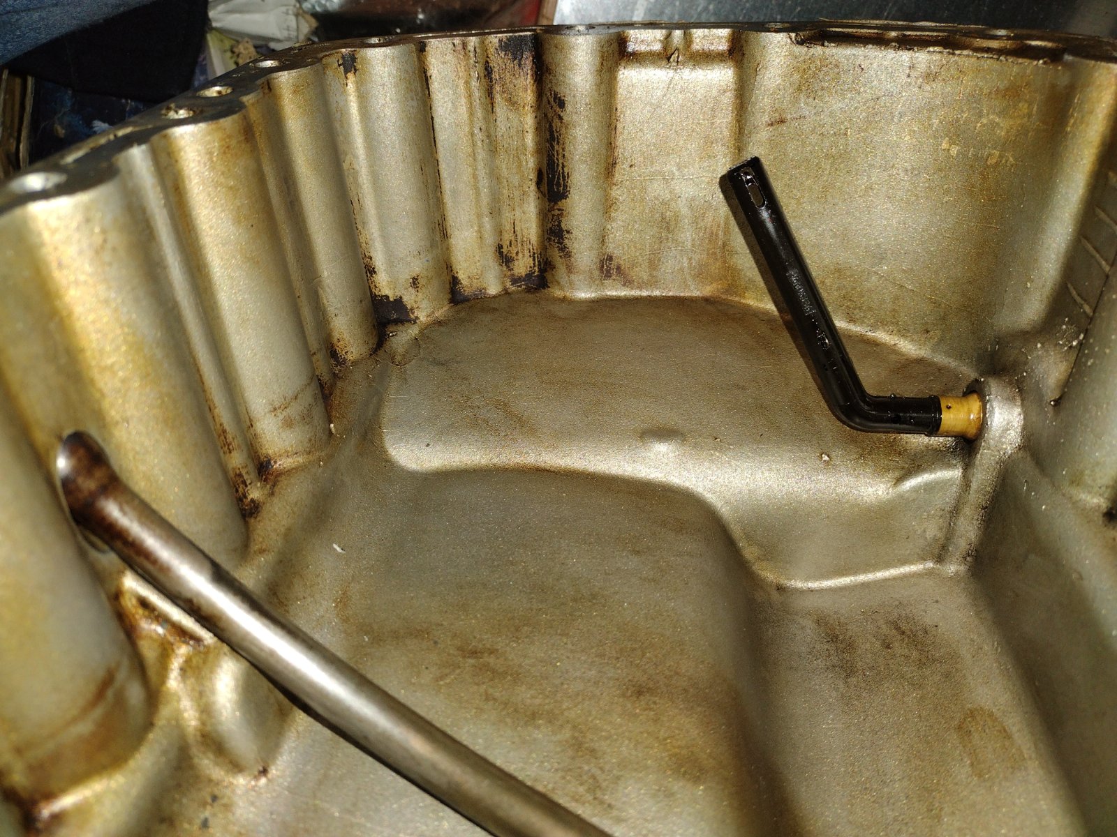

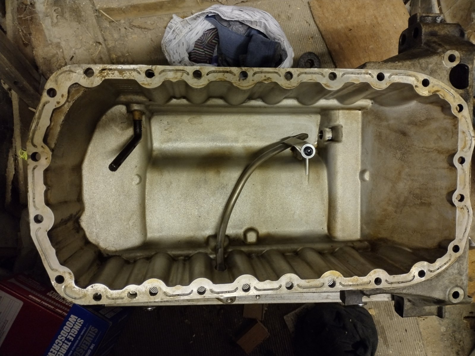

And after
After
After
After
After
After
After
After
After
After
After
Far from perfect, but suffice to say I don't feel like I was wasting my time there!

Having seen the state of the sump Matt, are you now considering a full engine overhaul? New shells and rings whilst it's all in bits might be a good plan...
Plus a good old clean-up!

CitroJim wrote: 24 Oct 2022, 09:27 Having seen the state of the sump Matt, are you now considering a full engine overhaul? New shells and rings whilst it's all in bits might be a good plan...
At present, no.
Probably about 18 months ago I found what happens if you carry too much speed down a very bumpy road in the Coupe, so had a cracked sump to replace, The second hand replacement sump, and the cracked one I took off all looked very similar internally, so I think really it's just what 15-20 years of use looks like.
I know so little about this cheap engine, at present my plan is to chuck it in the car and see how it goes, I can then decide if the Coupe's original engine or the "new" one is best candidate for a more involved refurbishment, or put this Coupe out to pasture and buy a V6 or who knows.
The Coupe has no oil cooler (more accurately no coolant-oil heat exchanger) so has less tight control on oil temperature. As such I was quite surprised that the EW10A (which does have the heat exchanger) sump was quite so horrible inside - thought it would be much nicer in there if oil not hot enough to burn on every surface! Obviously I've no service history or mileage record for this engine, so maybe it would have been lovely inside if it had enjoyed a cherished life!

You put some elbow grease into that job....could eat your dinner out of that sump now. Good work :lol:

Just for future reference, the muck wasn't that firmly stuck to the surface so special tools employed were:
  • wire brush for initial scrub
  • old socks as rags, holes in the toes optional :-D
  • WD40, just a little to help lift the greasness
Not sure what's best to clean the outside as much more stubborn. (And dishwasher is vetoed!)
Next job on this is to drill and tap a nice big hole in the sump and add a threaded hose tail: EW10J4S inlet manifold has a strange catch tank arrangement with drain connection straight to the sump - doesn't exist on the EW10A ( or the regular EW10J4)
