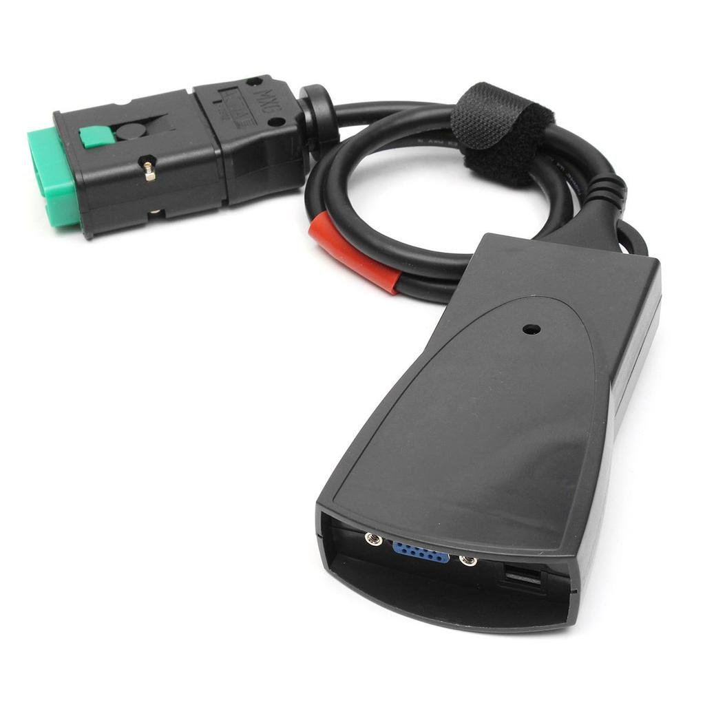

I believe the cable you require looks like this one
There's then a VGA to USB cable connecting that to the laptop.
There's some variations out there too involving a 30pin connector but the premise is still the same - obd2 into that 'box' then into laptop.
Normally sellers combine this with the software as as kit which sounds like you have seen.
