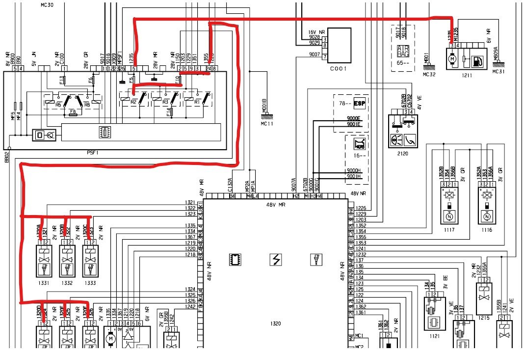

Is this the ES9J4S engine? I would be suspecting a fault with the engine bay fuse box (BSM), but check ALL of the fuses first.
wheeler
Posts: 7932
Joined: 21 Sep 2002, 19:07
x 1056
Re: Crank no start 2006 C5 V6
Unread post by wheeler »
Agreed (assuming all fuses are OK) the under bonnet fuse box would be my first suspect here. The power to the injectors & fuel pump are normally supplied from the same relay inside the fusebox. Might be worth unplugging it & checking for any signs or water ingress.
To get the correct wiring diagram for your car we would need your VIN.

The Injectors & fuel pump share the same outputs.
