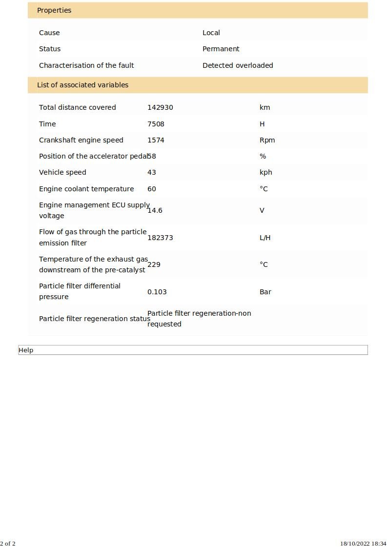

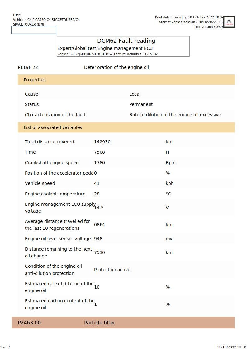

So, attached diagbox 9.91 and read the fault codes when Service was in yellow:
  • P119F 22 (Deterioration of the engine oil - Rate of dilution of the engine oil excessive)
  • P2463 00 (Particle filter - Detected overloaded)
The problem with the oil - it was completely changed in July, albeit I don't know which oil was put in it (my fault...). Car is driven cold a lot and in the hilly neighborhood.
In the report it says: Distance remaining to the next oil change 7530 km.
So, I've deleted the errors and went for the forced DPF regeneration (in hindsight probably a stupid idea). It ran for 2 minutes, then red STOP and engine fault. Car's motor shut down.

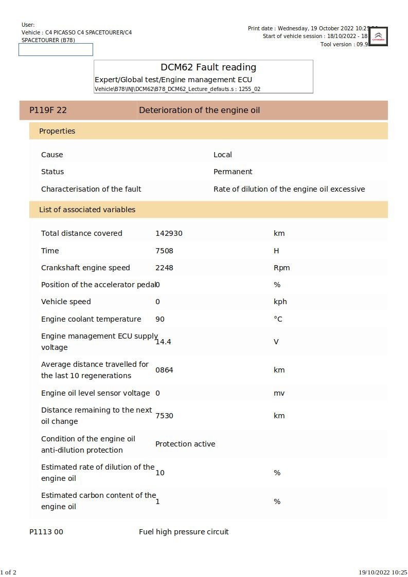

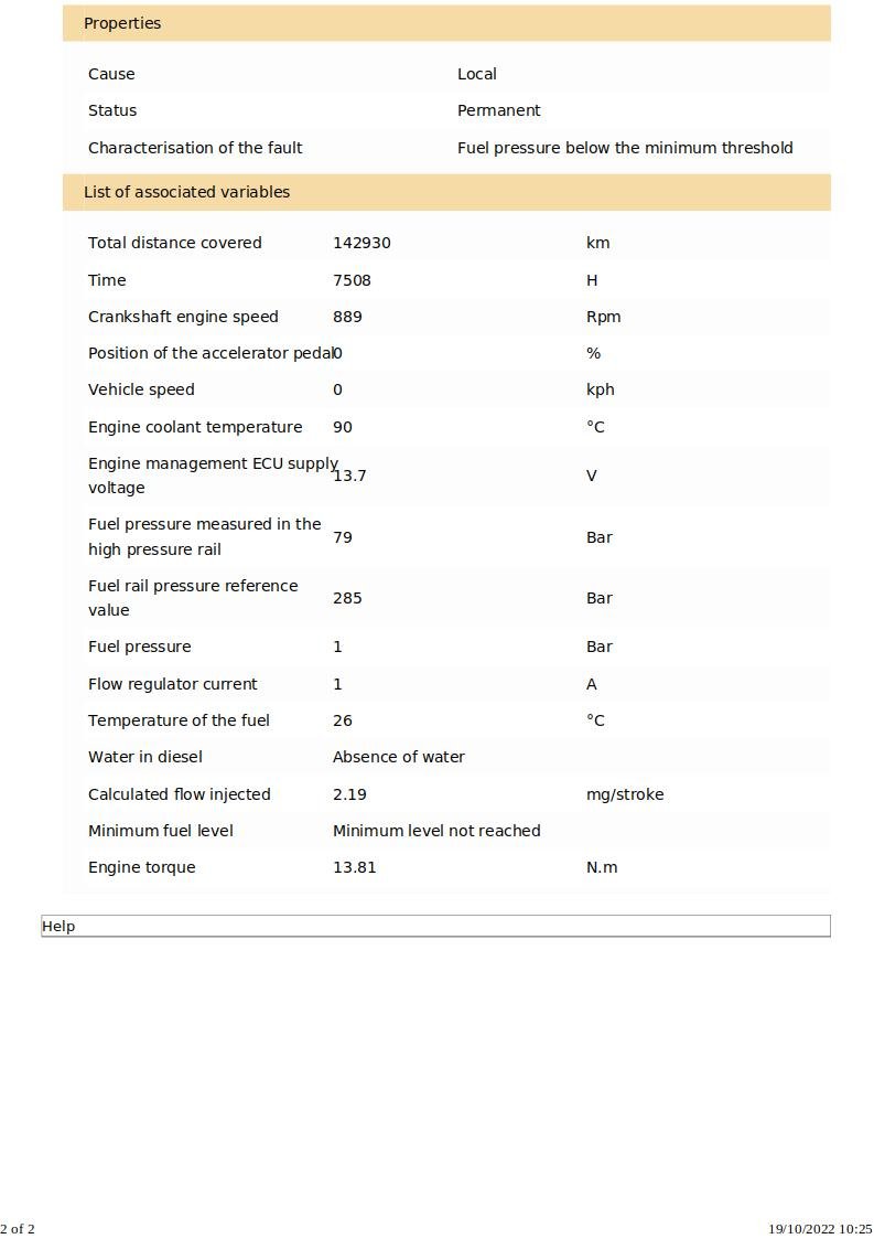

ECU errors now are as follows:
  • P1113 00 (Fuel high pressure circuit - Fuel pressure below the minimum threshold)
What did I brake?

High fuel pressure i would be reading live data of the fuel pressure sensor and surround sensors connected to the fuel rail and comparing the factory specs against what you have on live data.
The oil dilution will probably be related to the dpf issue in as much is it injecting fluid into the fuel system if that's what's fitted and because its not able to regen keeps injecting into the fuel which is causing the fault?

My observations:
According to the report, your car has done 142k KMs and the recommended check for DPF clogging on this vehicle (and I assume it is a DW10FD, but I would need the VIN to check) is 180K KMs.
So you are not far of the limit and of course this will vary depending on driving type and journeys - which again, when I look at your distance covered over the last 10 regenerations is only 864 KMs! So that tells me it is getting blocked up quickly as it is trying to regenerate about every 86KMs. So either you are driving very short stop and start journeys or the particle filter is getting full and needs replacing or deep cleaning.
As for the P119F22 fault, this requires an engine software update and a change of engine oil:
  • Reading the fault codes.
  • Downloading of the engine management ECU software.
  • Downloading of the automatic gearbox ECU software (if necessary).
  • Engine oil change.
Also, some of these vehicles have an after sales campaign if this is the DW10FD engine. I will be able to see if yours is outstanding once you provide your VIN.
