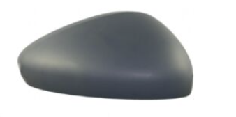

My missus is in the UK & has just told me the rh mirror of her 2014 C4 berline has been damaged with a clash of mirrors with another car which didn't stop.
Apparently it's lost the case but all functions still work.
I can get a case online here in France for painting & fitting when she returns but not seeing the car I've no idea how hard/easy it'll be to fit a new case.
I'm trying to sort this out at distance & her description is typically vague so any advice would be appreciated. Do these things clip on/off or is there more involved?

If it is the top rear shell, then these just clip on:
However, if it is the mirror frame itself (the housing that contains the mirror glass), then that is part of the complete mirror and can't be purchased separately. Obviously, without seeing the damage we can't advise you further.

Thanks Marc
From what she's told me it sounds like it's just the shell.

Just received photos.
It's just the shell with a very small crack in the lower part of the mirror body which I'm sure I can repair. She's found the original in the ditch at the crime scene. Unfortunately it's got a bit missing so new'un required.
It looks like the shell drops onto the upper part of the body & then clips down onto two clips on the bottom. If this is the case no problems envisaged.
