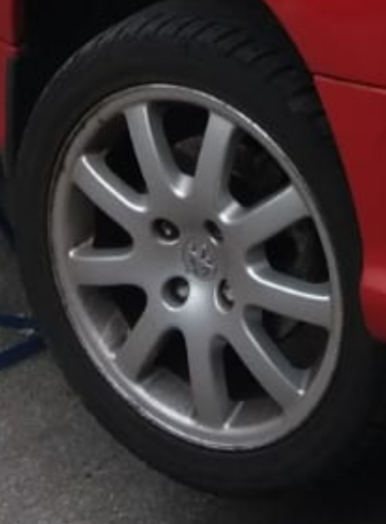

If it's same as 306 (think so), then the 15 inch wheels you have should be fitted with 195/55R15
These are commonly substituted with 195/50R15 as the 55s are much more expensive (e.g when I bought some Uniroyal rainsport 2 for my 306 it was:
55 = £75 each
50 = £50 each!
I'd go for the door sticker pressures, even though you've a different wheel/ tyre size.

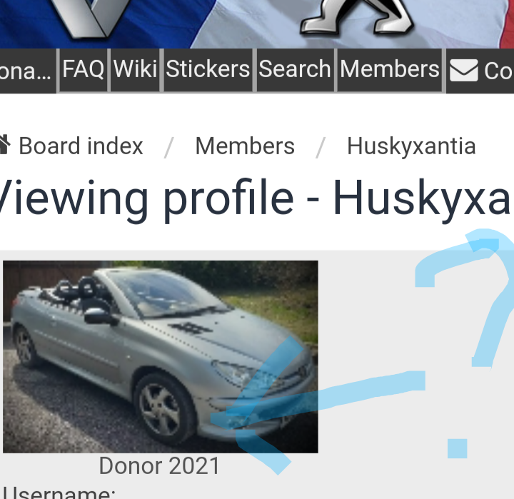

Hi Matt - Husky is referring to his 206 Cabriolet, not his 307, so has16" wheels fitted as per my post :wink:
Posts: 5338
Joined: 25 Apr 2022, 09:03
x 2356
Re: Air pressure
Unread post by MattBLancs »
I was going off this!
Thought they were the 15" wheels (sometimes known as Quicksilver wheels, can't recall their proper name)
Hey ho, feel free to ignore me with wrong end of the stick! :rofl2:
Matt
x 6945
Re: Air pressure
Well spotted! :)
@Husky: Can you go into your user profile and update your cars please - it might save a few of us from losing the plot :-D
