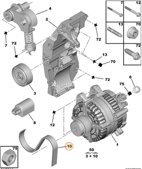

Would anyone have a diagram for the serpentine belt route as my belt fell off before i could get a picture.

Here you go:
Item (10)
OEM Original, part: 5750XC, £51.28
Citroen Cheaper aternative, Part: 1606354480, £21.43
I know this doesn't help much with the belt, but give me 20 minutes and I'll put a link to the replacement procedure on this engine that should help.
