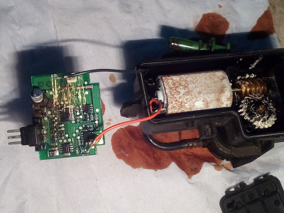

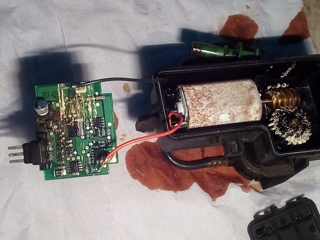

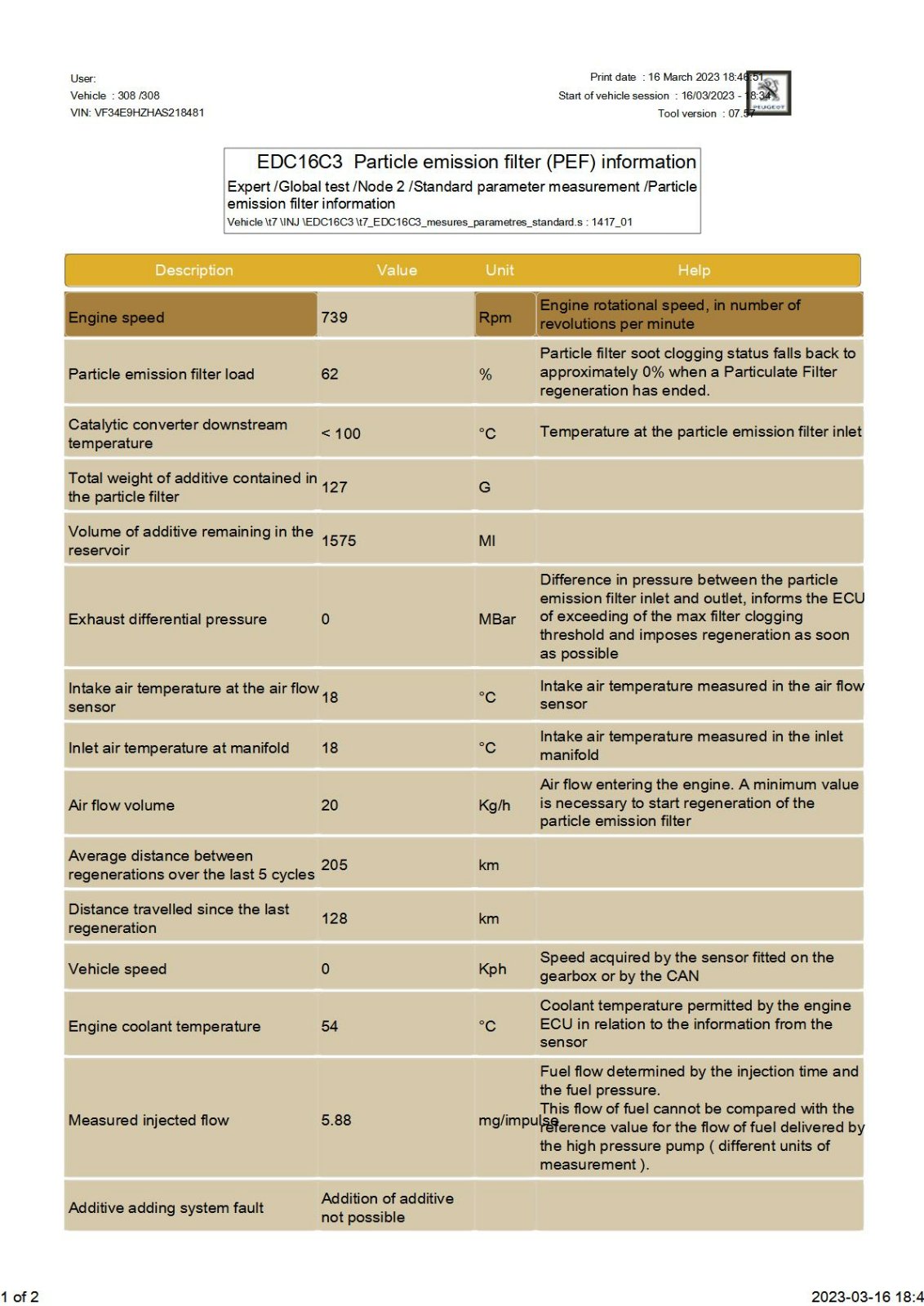

……. just to follow through on this one …………….
I get the warning ‘Triangle’ (all the time) + ‘Risk of Filter Blocking’ (at start), but have not had any ‘Diesel Additive low level’, or any other warnings. An EGR fault did come up last year and it was replaced (without advising the system). The car runs fine at ~55mpg (mostly long trips).
Couldn’t face buying a new pump from Peugeot for £200+ so got one on eBay (Citroen) for ~£50. Have just put this in and returned to DB 7.57. Removed pump as on the image attached.
The system now comes up with ‘POMPE_MAX_MGI’ as the Additive pump Control Unit. In the ECU Repair Pack I notified the change of pump and bag and it comes back with ‘Operation Completed’ on both. I still have P1434/P1435 in the ECU faults, but I am guessing these might work their way out. (+ P1351 pre-heat relay still to fix).
I assumed the pump would need to be ‘Configured’, but, as you said, this is ‘online’ needing PSA tokens, and 7.57 won’t do this either. However, the pump is obviously configured (for something ?) and so doesn’t seem to need this. EDC16C3 PEF Report attached - does this look about right ?
I’ve probably done ~ 60k miles (75k - 135k) with no Eolys injection so I am assuming that the displayed weight of additive figure - 127g - may not be correct, but regeneration does appear to clear the filter. The 3,000rpm pressure is 27mbar.
So I plan to ignore the warning for a while longer …. thanks Marc for your many helpful posts on this.

Ok, so the first thing is the
The additive pump may not need configuring, but it will need priming when replaced, which is done via Diagbox in the replacement parts menu. This undertakes a priming procedure to ensure correct operation. This is a maintenance operation so should be available. Ditto for the EGR valve replacement as that resets the adaptives.
. This will continue to appear as there is 127 grammes in weight recorded of additive dumped into the filter via the fuel over time. Although this is a calculated value, it is way over the service life of circa 97 grammes.‘Risk of Filter Blocking’ (at start)
