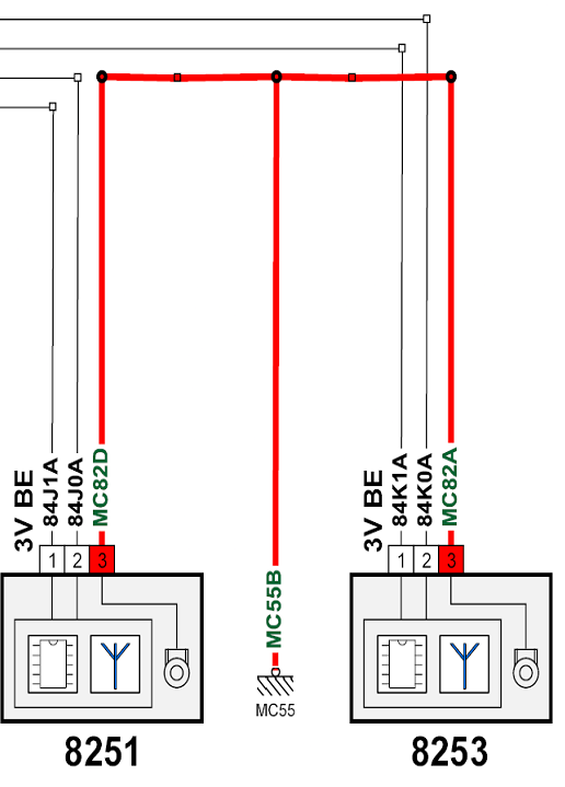

Ok, so the fact that everything works with the remote fobs indicates that the central locking itself works fine.
The issue is likely to be with the hands free door control units (shown below) on those affected doors or a wiring issue:
Having taken a look a the circuit diagram, I can tell you that both these units share a common earth point on the car:
As you can see below, the earths MC82 A and D are connected:
8253 : rear RH exterior opening control module for the hands-free starting access
8251 : front RH exterior opening control module for the hands-free starting access

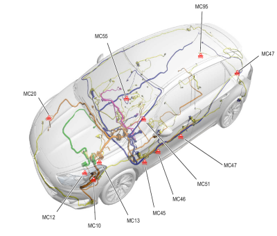

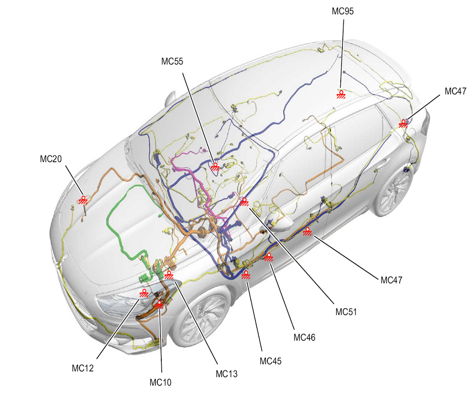

.. and this is where those earths are linked to point MC55B on the vehicle body:
