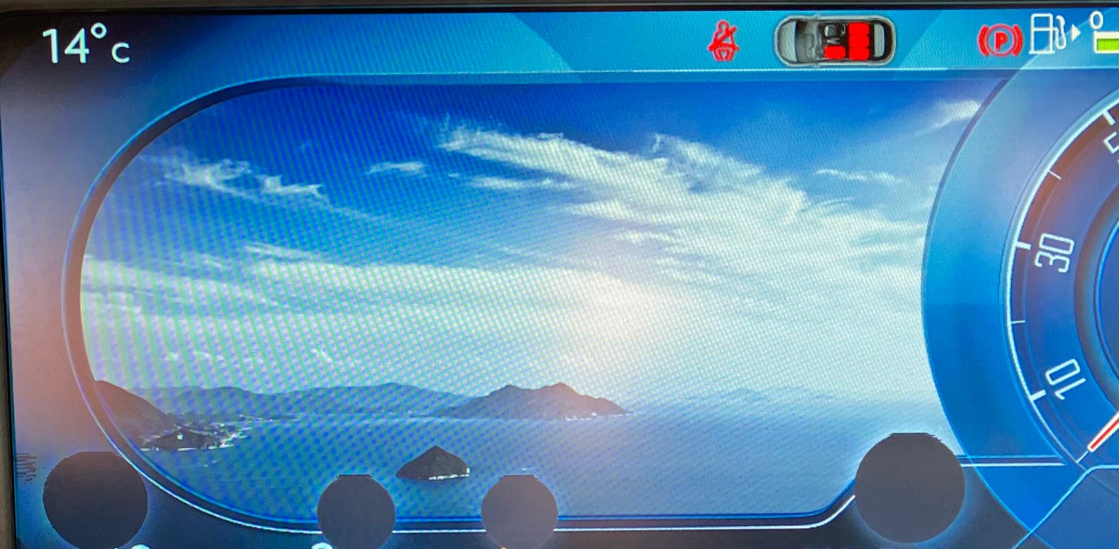

My C4 Picasso has developed some black spots, circles, disks on the display. Is this a fault? Isn't it weird that hey are circles? In all my years of using computers, glitches are usually a bit more random than that!
On the photo, note the 4 spots at the bottom of the display: a large one, two smaller, and another large.
Any thoughts, please?

Is it LED backlit? If so looks like some LEDs have failed.

Peter.N. wrote: 08 Oct 2022, 23:29 Is it LED backlit? If so looks like some LEDs have failed.
I'm not sure how I'd find out. It seems bizarre that they have such a hard edge, though. Do you suppose they'd be replaceable or is it going to cost me a gazillion pounds for a new display?

It's a well-known issue - a manufacturing fault with the instrument panel screens on this vehicle. Even new replacement have suffered the same fate.
They used a new screen from vehicles built from 24th August 2015. Note that this is the actual vehicle build date not the registration date! So you could have a UK 2016 registered vehicle for example, that was built in 2015 before 24/08/2015 with this issue.

Bother. Is it likely to get worse?

That's hard to say to be honest, but you may want to call Citroen as there was a technical bulletin concerning these display issues with the instrument panel - they may be willing to replace under a goodwill gesture.
