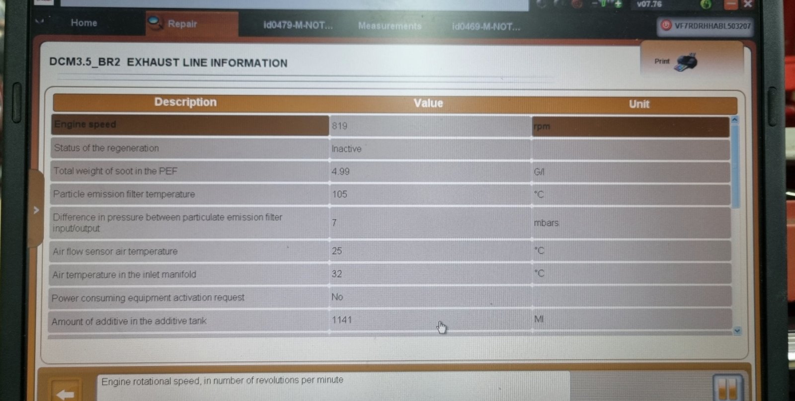

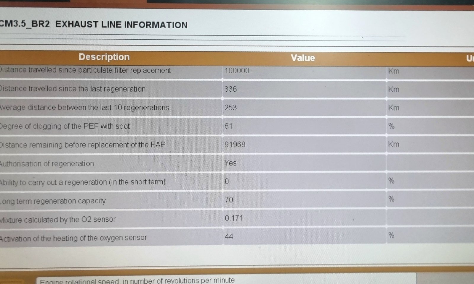

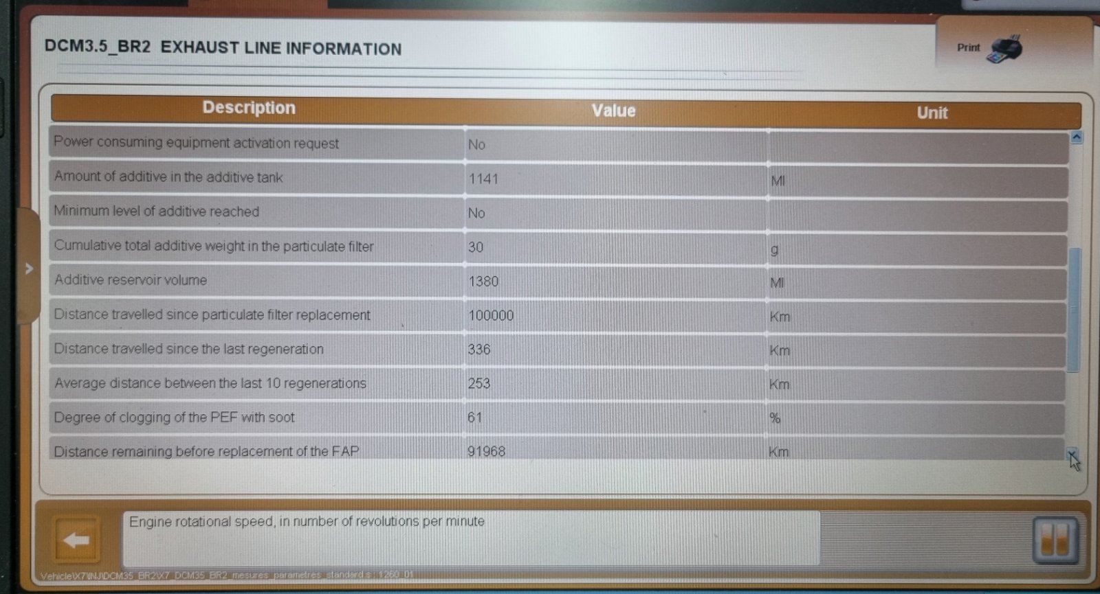

Marc - I appreciate your suggestion to add a litre however.....
I have just dug out the Diagbox and after a little browsing manged to find the information about the Eloy levels & PEF condition.
If I understand the information correctly I wont need a top-up for another 91,968km (57,000 miles). As I am now doing less than 8,000 miles a year this is about another 7 years before its empty, or 5 years before it requires filling!
Info from Diagbox
I read on table on another screen that there have been 92 pumps - Would this be from new, what volume is injected per 'pump'?
"Amount of additive in Additive tank = 1141 Ml" - According to the amount left vs the tank volume it has used only 239 Ml since last fill - I have not added any
"Additive reservoir volume = 1380 Ml"
"Degree of clogging of PEF with Soot = 61%" - is this value current and will it be lower after next regen?
"Distance remaining before replacement PEF = 91968 km"
My dilemma is:-
Do I believe the numbers and leave it another few years and wait for the warning message.......or do I buy a litre and top it up and store whats left in the bottle?
And looking at the info I have am I right in saying it should have "InfineumF7995" (9736.98) as my RPO is 12489, without checking to see if it has a Green retaining clip.
Appologies for long post and thanks for reading

Re: When do i expect to top Eloy tank
You need Eolys EXTEND for your C5 X7 Stu. This is the replacement for Infineum F7995.
From the looks of it, you don't need topping up for ages yet, so leave it as you have only used a third of the original additive added at the factory.
The soot count will rise and fall depending on when you run the diagnostics and of course since the last regeneration was undertaken.
