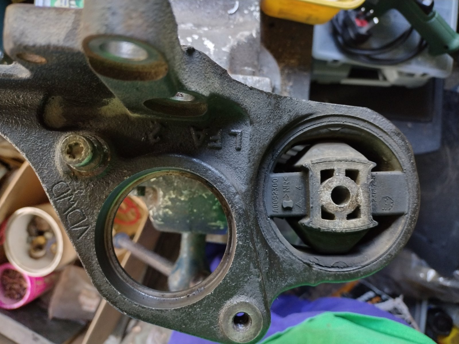

Not aware of an in between bush, but can offer an idea.
The bush has two sections that connect inner and outer , 180° apart. And two sections on the inner that have a slight air gap, 90° to the other two
As standard, bush is installed so the air gap bits are at 3 o'clock and 9 o'clock. The bits that connect are of course 12 o'clock and 6 o'clock.
In this configuration, top and bottom sections are in shear - under torque reaction of the engine - and the air gaps allow some forward and back movement before compression of the other sections.
If you install the standard mount at 90° then you'd get the connecting sections to be compressed by the torque reaction forces (and top and bottom air gaps largely doing nothing) this would be stiffer than standard.
Of course there is also a myriad of in between positions where you'd have some compression, some shear.

Thought I had a picture of my new mount at the different angle, but can't seem to find it at present.
Was going to add that I can't fully recommend this mod as I've had issues getting the car running for a while, so haven't yet given this a long term test.
Had a powerflex yellow bush in a previous car (406 coupe with a EW10J4 petrol 2.0) didn't notice much vibration, but a different kettle of fish for a diesel.

Interesting you had bad results with the C5 + yellow powerflex. As above I put one on a EW10J4 2.0 in a 406 Coupe and could hardly tell any difference.
Suppose the other thing to ask / point to raise:
Bear in mind your current "too soft" rubber bush has been under there doing its job for a long time (2007 Berlingo) - so a new like for like replacement may yet be a step in the right direction!
Matt
Matt

Can confirm the powerflex ones are very easy to fit. Did the one on my previous Coupe in situ, chopped the rubber, then junior hacksaw blade unclipped, threaded through then re-engaged in the saw handle. Then saw away at the outer steel ring (taking care not to damage it's housing) for what feels like an eternity.
I remember that job well - was a very changeable day and half way through the sawing a massive thundershower suddenly arrived. So I carried on under the car with rain bouncing off the ground, pouring off the car, on all sides around me!
I was nice and dry laid on the creeper under the car , or so I thought, untill post rain shower, post sawing through, I stood up. At that point I had a very unpleasant realisation that my trousers were hanging down off my legs and so were sitting in the water traveling under the car...
The new powerflex bushes simply push into the housing by hand, dead easy.
The standard bushes are either hydraulic bench press or wallop into place with big hammer. No chance of that under the car.
I think if it were me I'd go for the "standard bushes turned through 90° option".
But if it was me I'd also do gearbox oil replacement.
And if doing that I'd likely do gearbox driveshaft seals.
And (assuming Berlingo is same as 306 at front - think so) I'd also consider doing ball joints if looking tired.
And then I would look at the wishbone's rear P bushes too.
Oh well, at least the bits are all quite cheap!
Matt

Interesting perspective from someone who has the mount installed 90° to standard here:MattBLancs wrote: 09 Oct 2022, 20:44
Matt
viewtopic.php?t=72746
(Albeit not a C5)
And would encourage caution at following my suggestion above!
