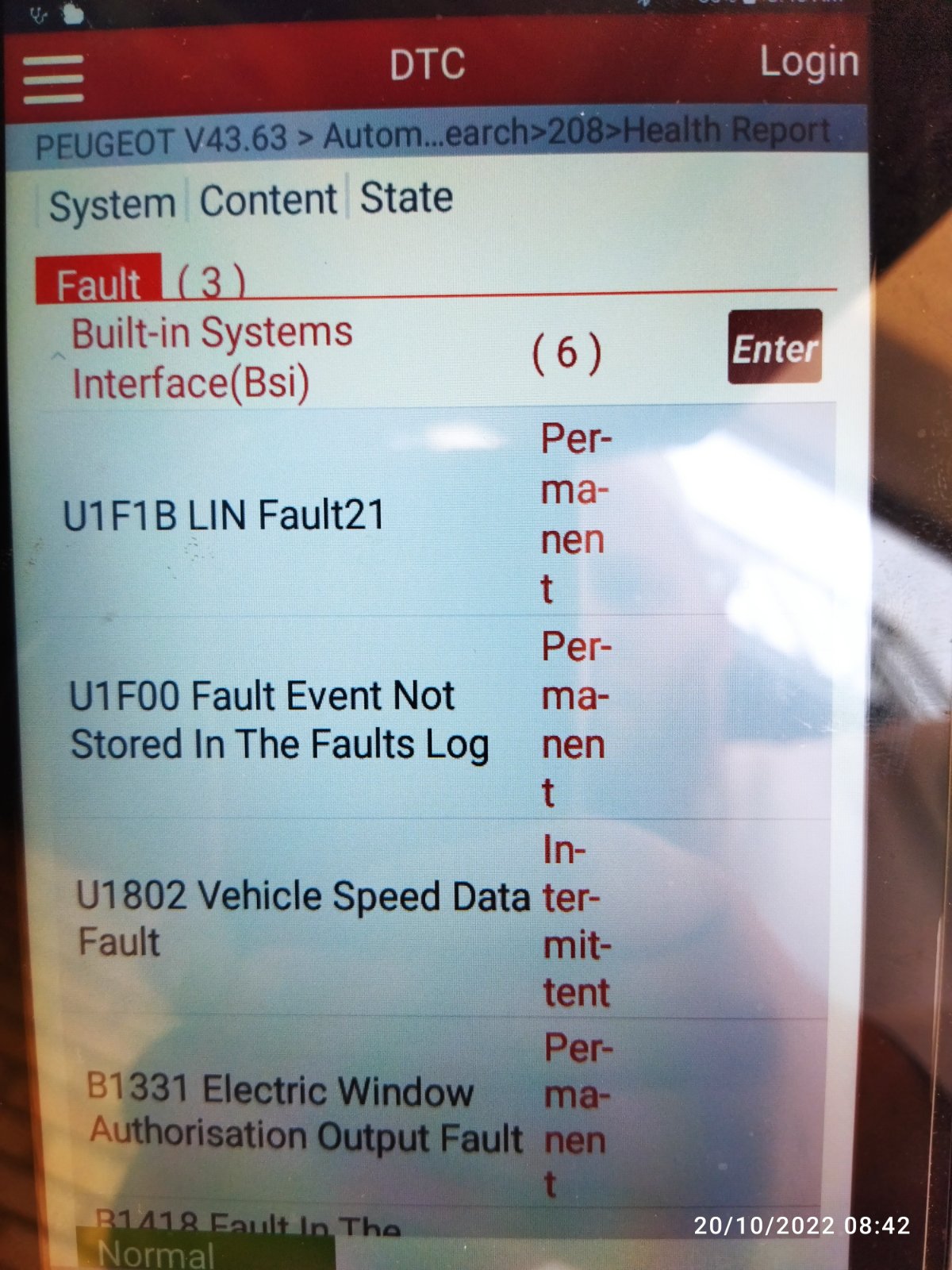

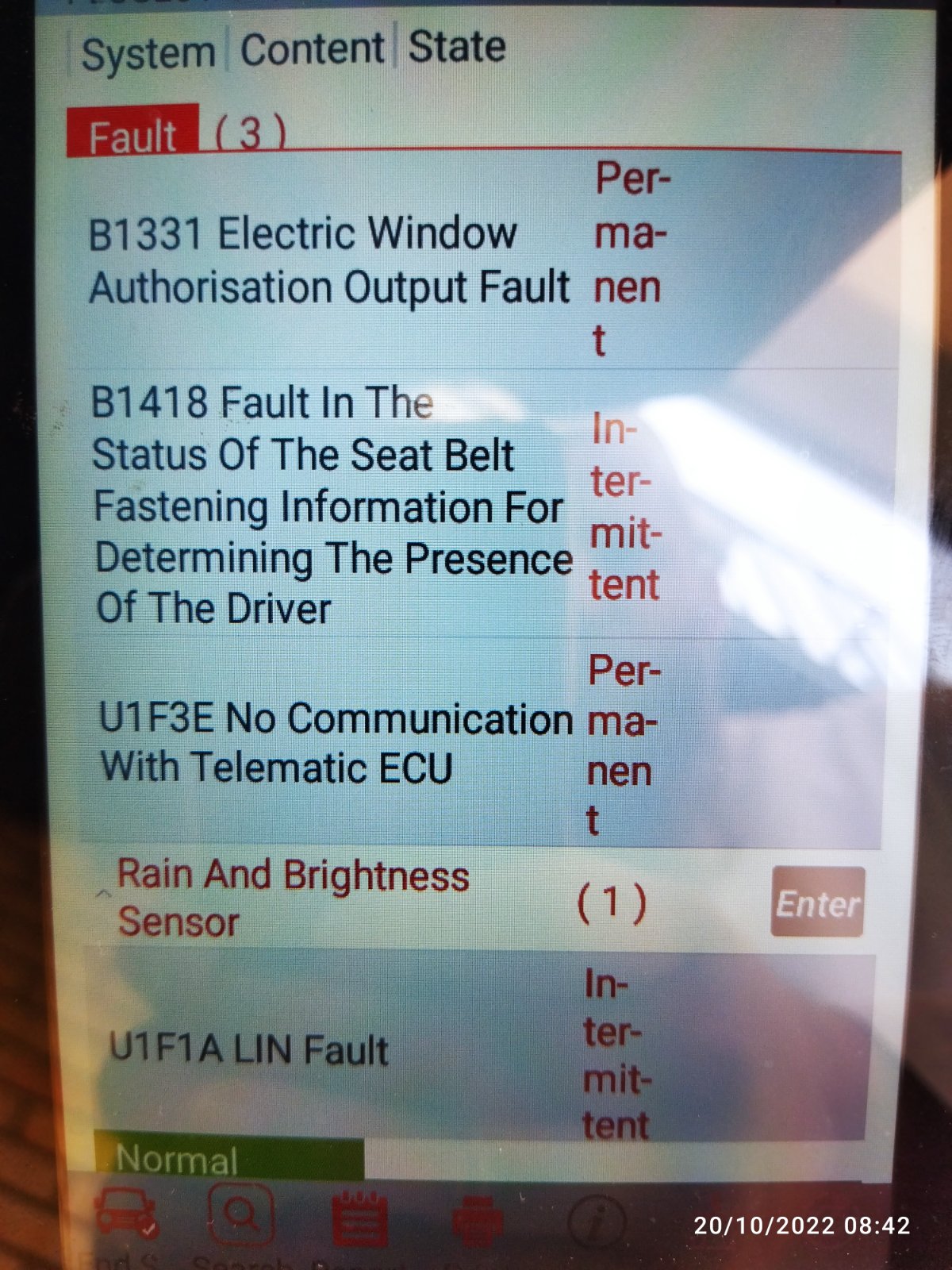

Those faults are permanent:
U1F1A LIN FAULT21
U1F1B LIN FAULT
U1F00 fault event not stored in the fault logs
B1140 front left fog lamp control fault
B1331 electric window authorisation output fault
U1F3E no communication with telematric ecu
[(B1418 seatbelt Status -* but that one is only because I leave the seatbelt plug in*-)]
Unfortunately there is no further digits for them.
Sometimes they can be deleted. My actual problem with these faults is actually that my engine light comes on. I don't understand why though
Please advise. Thanks in advance
However: is there any information where exactly the CAN network wires are situated in the vehicle?
There is many issues that may be related. I had my wires getting checked a few month ago, not sure if really all were checked but I hope so, even the fuse box, BSI and the fuse box on the driver side.. all good.
U1F1A LIN FAULT21
U1F1B LIN FAULT

Re: Peugeot 208 (2013) 1.6l VTi automatic -FAULT CODES-
B1331 can be ether:
B1331 11 (Electric windows authorisation fault: Short circuit to earth) or
B1331 15 (Electric windows authorisation fault: Short circuit to positive or open circuit)
B1418 00: Fault in the status of the seat belt fastening information for determining the presence of the driver.
U1F00 00: Fault event not stored in the faults log.
| Fault Code: | U1F1B 08 |
| Description of Fault: | LIN2 fault. The BSI detects a short-circuit to positive or a short-circuit to earth on the LIN2 network wire. |
| Conditions for Fault to clear: | Absence of electrical faults. |
| Downgrade Modes whilst Fault is active: | Change to energy economy mode 5 minutes after cutting of the engine. Switching on of the warning lamp and/or warning message: Possibility 1 "Economy Mode Active" message Possibility 2 Flashing of the battery warning lamp for 7 seconds |
| Symptoms: | Multiple customer complaints. |
| Suspect Areas: |
