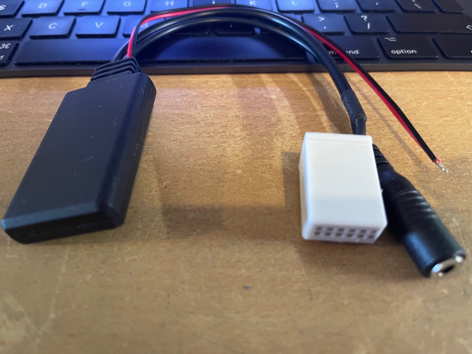

Upgrading the C5 X7 audio to something useful is a pain in the ass, so I’ve resigned myself to making do with the RD4.
I picked up one of these Bluetooth adapters from Amazon, which replaces the glovebox AUX input. I’ll let you know how it works once I find my soldering iron…I wish I’d paid a little more for the version with the quadlock passthrough
