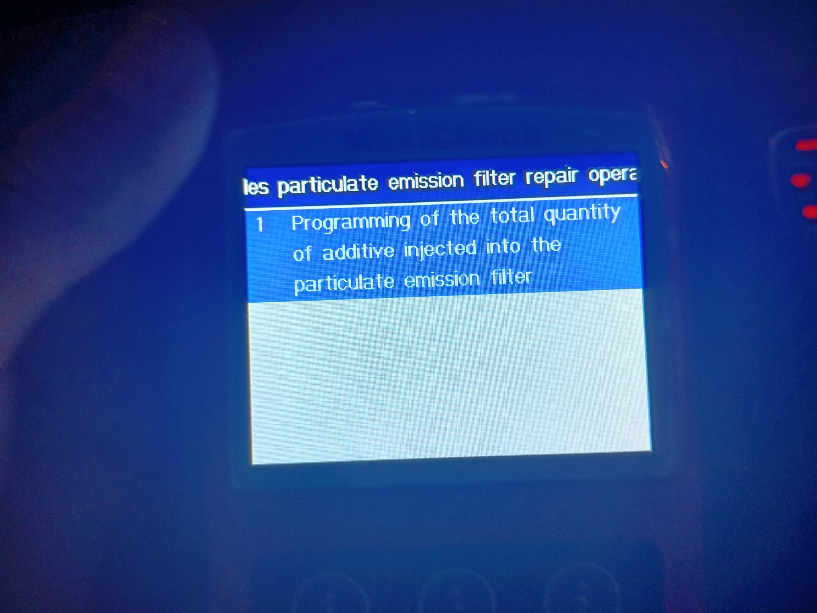

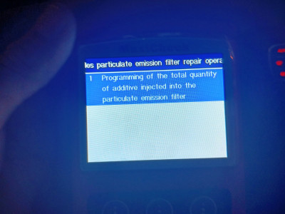

Basically brought a secondhand additive tank and pump of eBay and toped up the eolys fluid to about 2ltrs
Pump all working and now fitted back to the car.
I have an Autel plug in machine and when going through the codes and settings came across this
"Program of the total quantity of additive injected into the particular emissions filter"
"configuration of the amount of additive in the particular filter in grams ?"
So does anyone know what figure I add to this ?
I assume I need to add a value so the pump pumps the correct amount of additive through ?
Autel message
Autel message
Thanks and sorry if already been asked 1000 times already
x 6955
Re: Program of the total additive injected in grams
You shouldn't need to touch this for replacing the tank. The Eolys additive contains Cerine and this cannot be burned through regeneration - minute particles remain inside the particle filter. Each time the additive pump injects a quantity of additive into the fuel tank, the engine ECU records the estimated amount of cerine in grammes that has been injected. At some future point it will flag a message when it deems the particle filter needs replacing as a result of these elements blocking the filter.
This is the wrong function for what you are doing. You need to be looking for a setting that resets the additive counter. You would only use the setting in your photo when you have replaced or deep-cleaned the particle filter.
