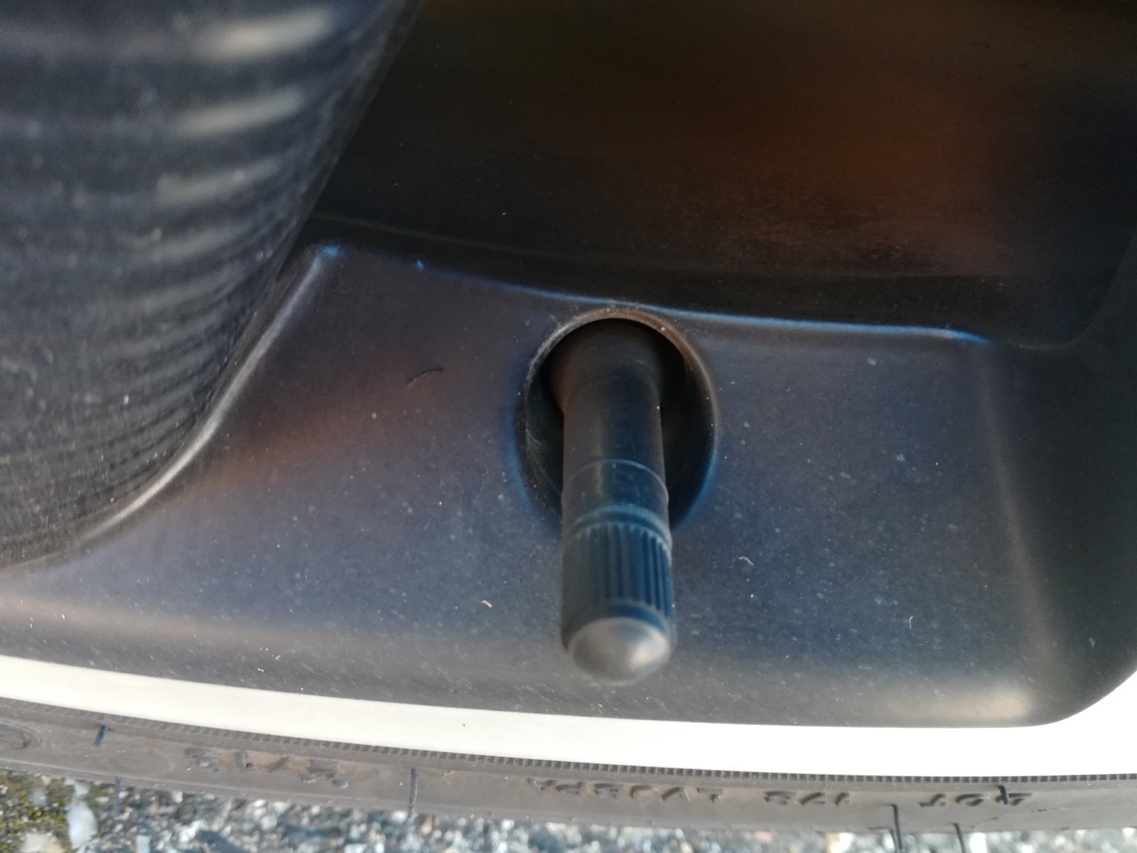

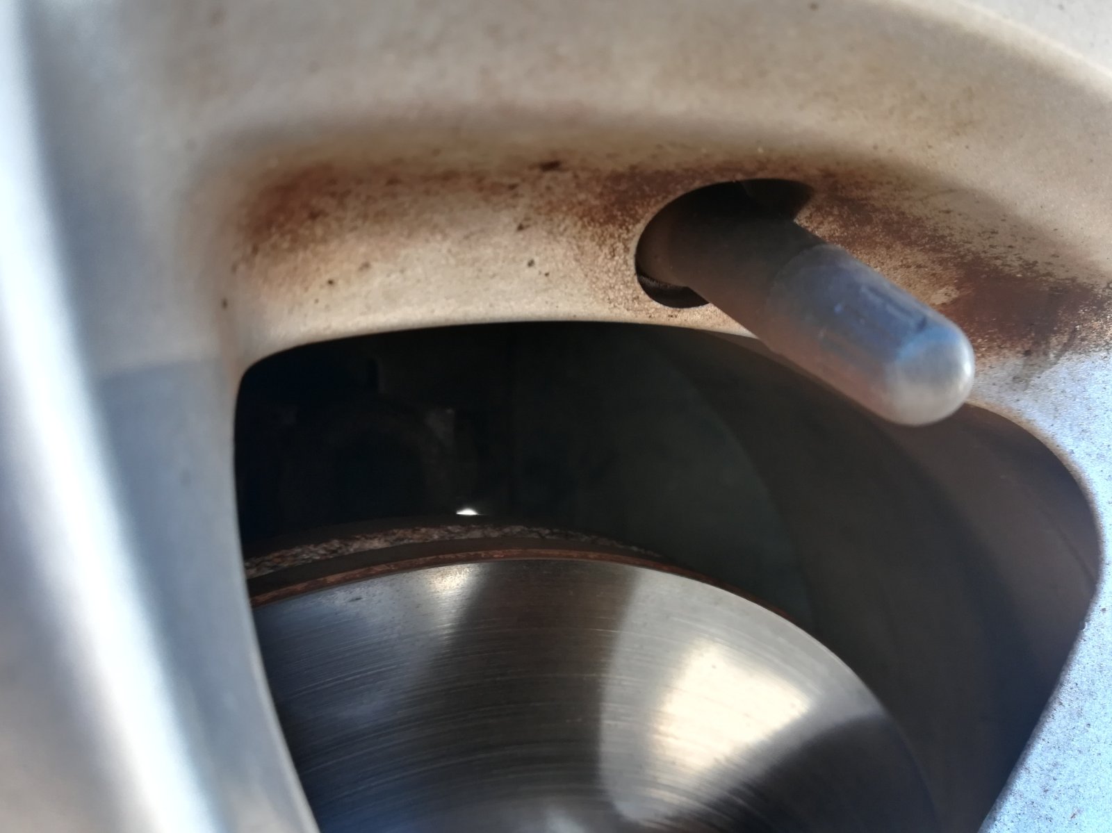

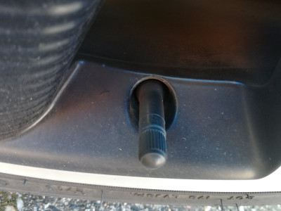

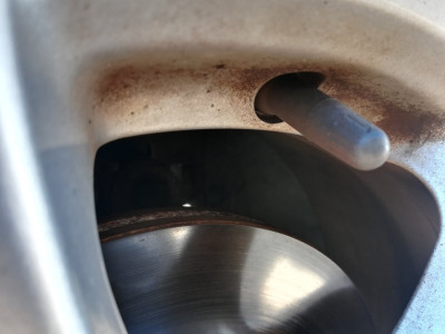

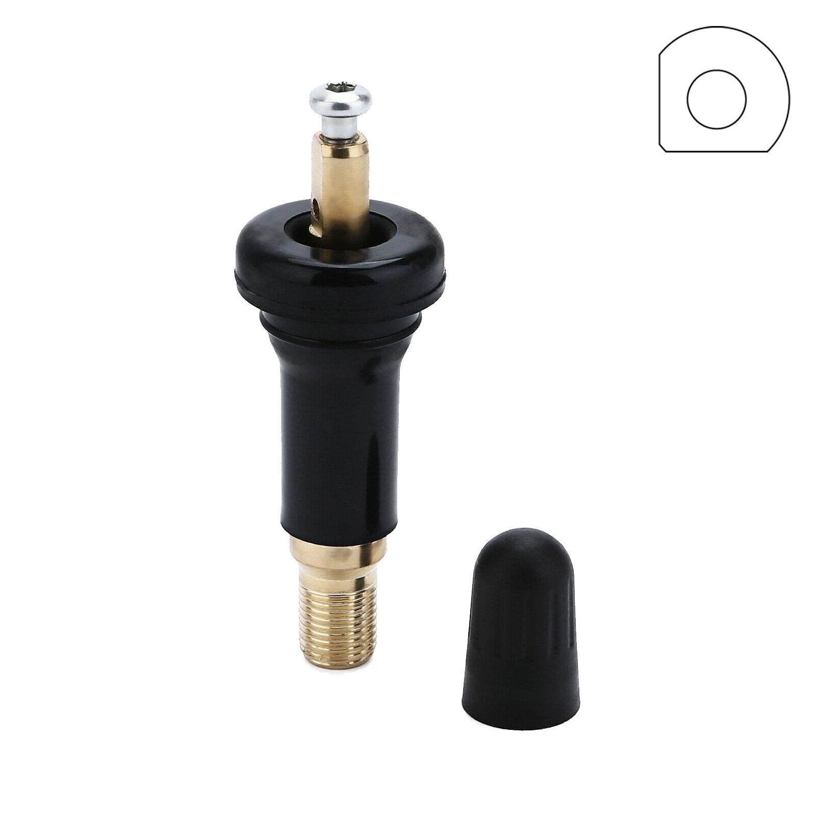

They're definitely rubber valves, and they're definitely TPMS on the Berlingo at least, I've seen them when they were swapped from the original steel wheels to aftermarket alloys and also know that I get a yellow light all the time I'm using the spare wheel. I've also had a conversation with the Citroen dealer about them when I was asking about adding a fifth, which they said is not possible. They're possibly a bit thicker than normal ones, but they look utterly unremarkable.
Here's a photo of the Berlingo TPMS valve stems...
And here are the DS5's valve stems - yet to check for certain, but I'm fairly sure these are also TPMS...
The early TPMS valves were metal, but these were quickly changed to rubber ones. I don't know whether there's a recommendation to routinely change them, but I haven't bothered in 8 years of owning the Berlingo.

https://www.ebay.co.uk/itm/124638942011
As I say, I've yet to work out which system our 2016 DS5 has. But a 2013 model is more likely to have the same system as our 2014 Berlingo. This was the system they started using when it was first mandated but then they worked out they could do it cheaper and better without all this radio nonsense so switched to the revolution counting, presumably using the ABS sensors that were already there anyway.

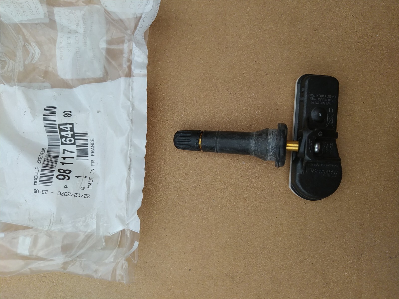

This is a complete original unit...
https://www.ebay.co.uk/itm/334539661858

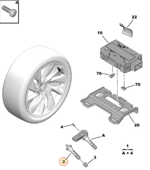

This is your system on your DS5:
The sensor itself is show separately at (1) which includes the valve and the sensor.
The spare valve on this model is the complete valve as shown at (2), part: 1612093180, £6.68 each inc. VAT from Citroen.
