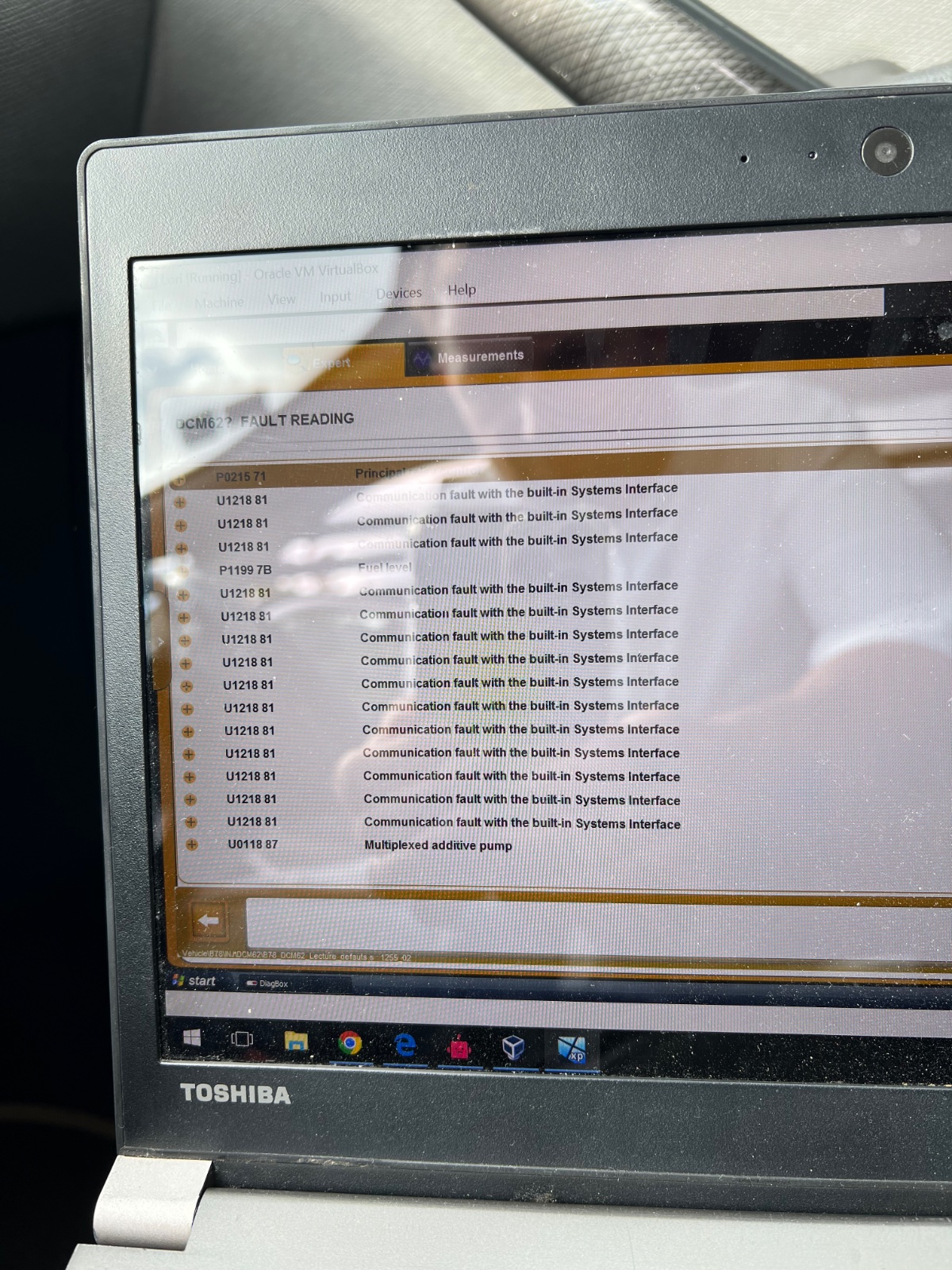

I am an owner of a 2014 C4 Grand Picasso 2.0 Blue HDI 150ps.
Car was working fine,but when i wanted to start it a week ago it refused to start. (Cranking.but not starting) After a disconnected the battery, it started right away.
Since then i got the UREA warning, but disappeared after topping up with adblue. The car is working fine without any errors on the dashboard.

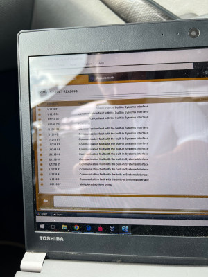

Today i wanted to check with diagbox what must have caused the error. Surprise: full with error codes.
Maybe somebody had the same experience and can advise. Thank you
the errors look like this
P0215 71 Principal relay control

These basically mean you have a communications issue with the BSI which is the master controlling computer on the vehicle. All the other ECUs communicate with the BSI directly or indirectly, so there is something going on that needs further investigation. The last fault relates directly to the DPF additive pump which I can't help with specifically at present for this engine. It may well be a separate issue or related as the pump also communicates with the engine ECU and in turn the BSI.
