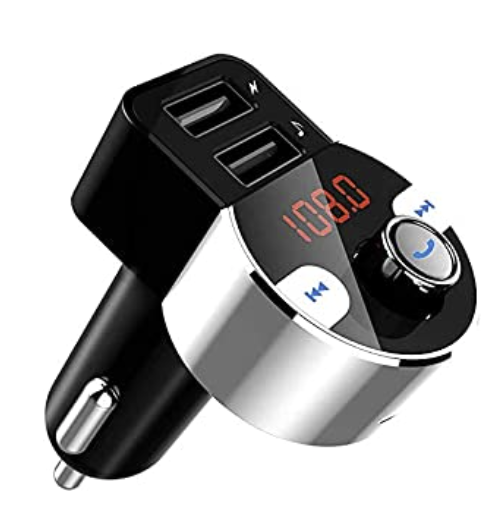

What about this Tom: It seems to do Bluetooth calls, streaming, and plays MP3s from flash cards etc. and has a built in microphone, so no messy wires and cables.
https://www.amazon.co.uk/FirstE-Bluetoo ... ast_sto_dp
Got to be worth a punt at £13.79! There are 17k reviews on Amazon with a 4.5 star rating.
