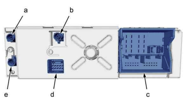

The LVDS is the cable that connects the colour MFD to the rear of the Head Unit.
Shown here as 'd' in the diagram at the back of the MyWay (RNEG):

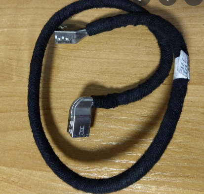

Re: RNEG LVDS connectors type
Like this:
zvezdelin
- Posts: 4
- Joined: 01 Oct 2022, 15:14
Yes, that's the cable. I managed to find the connector type that sits on the mainbord of the rneg. In one of the spanish forums there is a picture where one can clearly read
