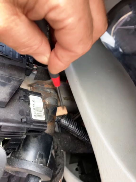

Turn the ignition key and no lights on the dashboard. Turn to start, lights still out and still wouldn't start. I found that by wiggling the keys in the start position the lights would flash on and off and the engine try to start but returning the key the lights would go out and the engine would cease trying to start. I stripped the cowl off and was able to jam a wedge of hard foam plastic between the wiring loom and the outer column. The lights would come on and further advancing the key would start the engine. Sometimes the lights would go out and the key needed to be wiggled. I pushed the wedge in a bit more and than seemed to sort it.
Position of the hard foam wedge

The video helped no end although my ignition switch put up much more of a fight to be extracted. Once out of the column I could check the continuity with my multi-meter. This showed extremely intermittent internal electrical contact and then I came to stumbling halt as the spot in my clip of 1/4" screwdriver bits had an interloping flat bit instead of a T10.
I checked out on Ebay and there are plenty new ones available quite cheaply but I said to my daughter I would wait until tomorrow morning so I could check out the price and availability of a genuine one.
When I got home where I have more tools I stripped the switch down and gave all the contacts a good scraping. After reassembly there's a huge improvement in conductivity. Not perfect but enough to give confidence driving home through the Mersey Tunnel tomorrow I think. If good enough I can then delay ordering one while daughter drives the van around to check reliability. You never know, it might be the forever fix!
